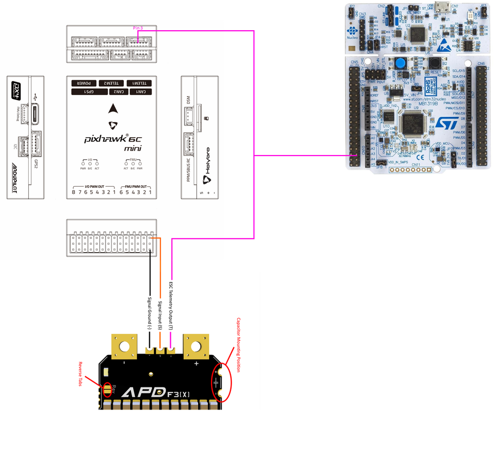

I am trying to receive a frame containing 10 bytes of serial data, each frame is transmitted at a 100ms rate.
However, as the UART can start receiving the 10 byte frame at any point in time, the received data is becoming out of sync.
How do I sync the UART peripheral so that it always starts receiving at the start of the 10 byte frame ?
Below is a scope capture of the 10 bytes of serial data:
Below is a scope capture of the 10 bytes of serial data being sent at a 100ms rate:
I am using the STM32 Nucleo-64 development board with STM32L433RC MCU.
Its as if I need to monitor the serial line with a timer, in order to detect the period when the serial line is high for say 50ms and use this timer to enable and disable the UART peripheral.  But there must be a better way to do this ?
The UART is configured as shown below and the rx buffer is a size of 10.
The 10 bytes are transmitted by a electronic speed controller, used for radio control applications and contains the following data:

Typically people would have a preamble/sync byte, if you're in-sync try to receive the whole packet, if not receive one byte at a time until you get the sync byte, then request packet size minus one?
Most of the STM32 interrupt for every byte, it's only the HAL doing the collection and callback stuff.
You could perhaps use 9-bit mode, and use the 9th bit to indicate the first byte.

I'm 90% sure that MCU has IDLE time detection on the UART. Which means you can trigger an interrupt after a programmable amount if idle time on the RX line. Have a look at HAL_UARTEx_ReceiveToIdle_IT() etc

Unfortunately I have no control over the serial data that is being transmitted, so I cannot change the data frame or add handshaking etc
The serial data is a standard known as "KISS ESC telemetry" and is transmitted by an Electronic Speed Controller (ESC).  The ESC I am using is as follows...
https://powerdrives.net/120f3
Details about the KISS ESC telemetry are explained in the attached pdf
I was hoping there might be a feature suggested by KMill i.e. an IDLE time detection on the UART so I can trigger an interrupt after a programmable amount if idle time on the RX line.  So I will investigate to see whether this is possible.

Unfortunately I have no control over the telemetry request either.
The datalogger has to be passive and "listen in" to the telemetry serial data.
The telemetry request is performed by a flight controller, in this case a Pixhawk 6C mini and in this case using a protocol called DSHOT (for some reason RC seems to use non-standard protocols  :face_with_rolling_eyes:).
The flight controller sends the DSHOT message which requests the telemetry data.
My datalogger has to then listen for the telemetry data response (from the ESC) and store the data to an SD card.
I've already got the CRC check working in my code (which I attached in an earlier post - see sdcard.7z)

Myself, I would think about these approaches to solve the issue:
1. receive a permanent stream and find the packet in receiver buffer:
Keep going to receive all what you see and place it in a buffer. The buffer should be at least twice the size of the packets, e.g. 20 bytes - or even longer, e.q. for Nx packet size (as 10 bytes). The buffer wraps to start (not a FIFO buffer with shifting inside the buffer).
When you have a finished DMA (assuming: using DMA and waiting for 10 bytes): iterate over the buffer and use the CRC check as indication where a packet seems to be correct:
Take 10 bytes from location 0, build CRC, if it mismatches: shift to start now to location 1 and do all again. Do this "incremental" move of packet start pointer until you find a correct CRC. Then the packet should be found.
Now you would know the "offset" where packets start in buffer. Keep going now to take packets with the "found offset".
(and bear in mind when the buffer wraps to beginning because buffer was full).
If the offset was found once - it should be clear where the packet starts are.
But you have to do all the time again when you do not keep going with this process, or you have a lost packet (start over with this "synchronization").
See David Littel's comment
2. Use the gap (time elapsed) to sync:
When you have for sure a difference between the gap the bytes of a packet are sent and the duration where nothing is sent - use this as indication where a new packet comes in:
Use UART in INT mode (not DMA), so, for every received byte you get an interrupt. This stores the bytes received in a buffer.
Measure now the elapsed time (e.g. via HAL_GetTick() ). If you see now that the next following byte comes 100 ms later (as the bytes before) - check the length received when you have started. Count on every INT the number of bytes you got and remember the time stamp.
If you see now, there was a gap (larger time now between two bytes) but you have not counted up yet to 10 (bytes received): the packet which you have in memory is incomplete: discard it and start again: back to buffer start, back to INT counter 0 and do again: receive and count, measure difference on time stamps. You should get now 10 bytes in a row before you see again "a gap" on time stamps. These 10 bytes are now your valid packet.
It works only in INT mode, with "single-byte" reception and measuring on every byte received the time (comparing time stamps). Not possible in DMA mode!
3. Monitor the external "sync" signal:
As I understood from previous comments: there is a signal which triggers the device to send these 10 bytes.
Why you cannot use this signal as "packet start" indication?
Configure a GPIO with INT (raising or falling edge), connect this signal as input to your MCU. When the two external devices are "talking" now to each other, you monitor this signal. You get a GPIO INT (with an edge) and this is an indication for you as: "now, make the UART Rx hot, be prepared to listen and to store the next 10 bytes in a buffer".
Now you should be in sync with the byte stream and you have locked onto the packets.
