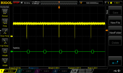

I am trying to receive a frame containing 10 bytes of serial data, each frame is transmitted at a 100ms rate.
However, as the UART can start receiving the 10 byte frame at any point in time, the received data is becoming out of sync.
How do I sync the UART peripheral so that it always starts receiving at the start of the 10 byte frame ?
Below is a scope capture of the 10 bytes of serial data:
Below is a scope capture of the 10 bytes of serial data being sent at a 100ms rate:

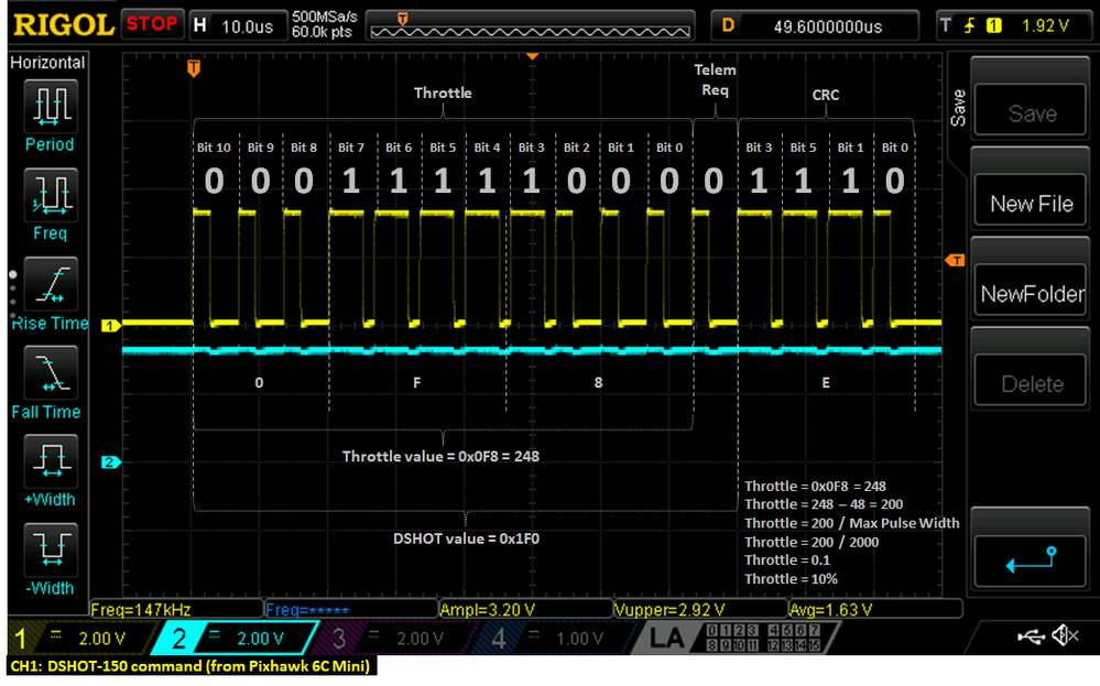

Possibly, but that would require writing a driver for this non-standard DSHOT protocol.  I can't see how any of the hardware peripherals could decode this protocol, so it would have to be all done in software which would increase the burden on the processor.
Below is a screen capture of the DSHOT protocol, it uses two discrete PWM duty cycles to represent 0s and 1s.
The DSHOT data frame contains the following:
  • 10-bit throttle demand
  • 1-bit flag to request telemetry
  • 4-bit CRC
The DSHOT driver would have to monitor the bit used to indicate a telemetry request,  then measure the duty cycle of that bit to see if its a 0 or 1.

The document tells you it's 115200 bit/s.
Doesn't say the format; guessing 8 data bits, 1 start bit, 1 stop bit, no parity - so 10 bit-times per data byte
So 115200 bit/s gives 11520 byte/s, or 87us/byte
So the 10-byte frame will take 870us (or a bit more if there's idle time between bytes)
So, with a frame every 100ms, that leaves ~ 99ms gap between frames ...
EDIT
which does correspond to your scope screenshot:
Thats correct Andrew
