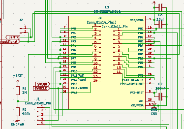

After receiving our first PCBs, we were unable to successfully program them with the stlinkv3 minie. Attached is an image of the schematic of where the STM lies on the board as well as the attached components. When the boards first came in the stm32 was able to be flashed with a program, but after the first flash they could not be connected to any more. This is with using an external power supply as the stlink v3 didn't seem to provide power as the prg tool was unable to detect the chip.

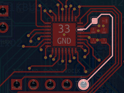

This is very frustrating as we have not been able to even test the hardware that we have designed for the past 2 months as we have been stuck trying to program the boards for so long. Any help or solutions that could be provided would be absolutely lovely. The layout of the microcontroller for one of the PCBs is also provided with the reset path highlighted. (Continuity of all of the paths has already been tested and there are no issues in that respect.

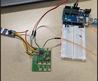

Is there a common ground between the board, the programmer, and the power supply? Show a picture of this.

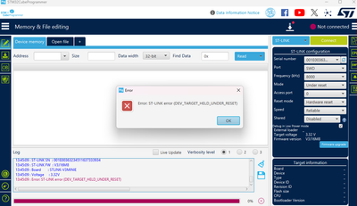

Does the programmer report the correct target board voltage? Show a full screenshot when you try to connect.
February 2, 2026
Yes, All three grounds are connected, im currently out of the lab and using an arduino as a power supply, not the most elegant solution, but it is what i used when programming the nucleo board. If you think its because of the arduino... I can go to the lab in about 45 minutes and send a screenshot from there, but the voltage on 3.3v is 3.3v, and the arduino can deliver more current than the mcu should take.

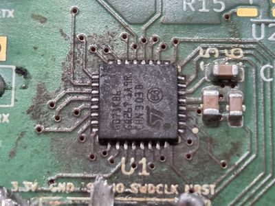

Also, the black around the microcontroller is from the flux that we used, it was old and discolored the soldermask.
February 2, 2026
This is likely a hardware issue. If NRST is stuck low, the chip may not have sufficient power. There's nothing wrong with this setup in theory.
Is the chip oriented correctly? That picture isn't close enough to tell. Pin 1 is bottom left when text reads from left to right. If you can, post a clear, large, in-focus of the chip itself and surrounding solder joints.
Turn your soldering iron down. The flux should not be discoloring that much, even if it's old.

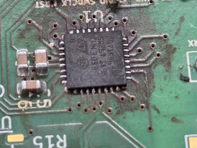

The  pcb software add3d an alignment dot to the silkscreen, that dot is lined up with the dot on the chip, so, im sure it is orientated correctly, also, since it was able to program twice before stopping i dont believe this is the issue.1000005458.jpg

It looks a bit like BBQ, sorry.
Maybe it got damaged while soldering?
February 2, 2026
While that is possible, the same problem has happened with multiple chips. The ic was installed with hot air gun set to 400f, this issue has persisted across 4 different stm32s that are across different pcbs, though ive used 2 on this pcb.

Orientation looks correct.
Capacitor solder joints look good.
Presumably the STM32 solder joints are okay too. Looks better than I was expecting from the first picture.
400 F is a good temp for leaded solder. The capacitor joints look good so the temperature is probably good even if the "400" setting is off.

The schematic is good, this isn't a design issue.

You have ports on SWDIO and SWCLK. Are they connected else where other than to J1?
If a reply has proven helpful, click on Accept as Solution so that it'll show at top of the post.CAN Jammer an open source CAN bus hacking toolCANableV3 Open Source
February 3, 2026
All of the ports for swd (clk io and rst) are only connected to the header for programming. I dont use them anywhere else. I can send a full schematic ss if needed.

dev_target_held_under_reset error usually means your code is reconfiguring the SWD pins as GPIOs or hitting a low-power mode the second it boots.
Since you can only see it in "hot plug," you need to jump into CubeProgrammer.
There set your Connection Mode to "Under Reset" with the Reset Mode on "Hardware Reset" to catch the core before your firmware locks the debugger out.
Double checking your power as well. if you're really drawing 70mA while idle with the programmer, you've likely got a microscopic bridge or a latch-up on that discolored PCB that's causing the flash mass erase to fail mid-cycle.
February 3, 2026
I have tried the connection stuff you mentioned, if you look in the original screenshot of the programmer those are the settings being used. As far as a bridge, that's possible but I'm not sure where it would happen, I've checked the wires multiple times and there were no shorts/
