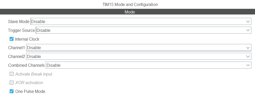

First of all, thank you very much for both of your timely responses. I have been fighting this for longer than I want to admit. waclawek.jan, your response took me 95% of the way to a working solution, so thank you very much for that.
I want to document here how I configured this for others and probably my future self.
Everything waclawek.jan said is true, but from what I can tell this can NOT be fully implemented using the MxCube tool. If I am wrong, please post here how to do so. Here is how I did it. Note again that I have my system clock set to 120MHz.
However, we are not done. MxCube does not seem to have a way to set "Update Interrupt Enable", so I had to do that manually within the MX_TIM15_Init() function within main.c.
static void MX_TIM15_Init(void)
 /* USER CODE BEGIN TIM15_Init 2 */
 htim15.Instance->DIER |= TIM_DIER_UIE; // Update interrupt enable
 /* USER CODE END TIM15_Init 2 */
Also, the provided APIs listed here did not work for me to trigger the timer, so I made my own function to do this manually.
Does NOT Work:
  • HAL_TIM_Base_Start_IT(&htim15);
  • HAL_TIM_OnePulse_Start_IT(&htim15, (uint32_t)0);
This DOES Work:
void TriggerOneShotTimer(void) {
htim15.Instance->CR1 |= TIM_CR1_CEN; // Enable Counter
Doing this allows the following ISR callback function to get executed about 45us later.
void HAL_TIM_PeriodElapsedCallback(TIM_HandleTypeDef *htim)
 if (htim->Instance == TIM15) {
  MyCode();
Everything now works. Again, thanks for the help!!!

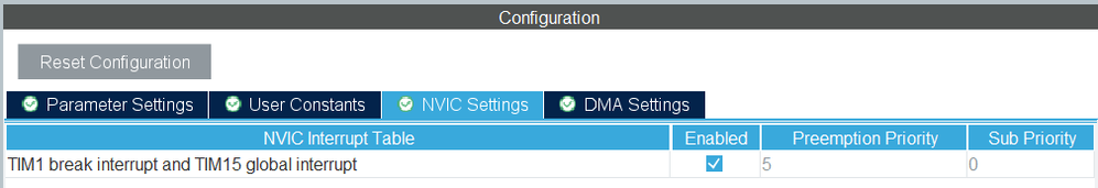

Never mind. The solution I just posted has a serious drawback. By calling
within MX_TIM15_Init() I now notice that none of my SPI ISRs are working.
How do I flip this bit without damaging other aspects of the system?
No, the peripherals are highly independent. And you are just flipping a bit.
There are HAL wrapper (stm32l4xx_hal_tim.h) for that like
__HAL_TIM_ENABLE_IT(&htim15, TIM_IT_UPDATE) and
__HAL_TIM_ENABLE(&htim15);
and those do just what you did.
You can also flip or watch the changes in the SFR (special function registers) view of CubeIDE while debug-stepping through the code.
Check how NVIC is setup. In the generated code this might be in a *_msp.c file.
Check the IRQ priorities, maybe a higher prio IRQ is blocking others.
Check that the peripherals get their clocks.
hth
