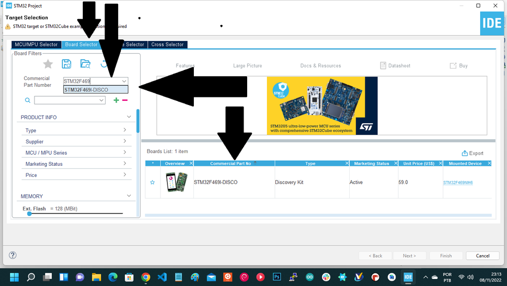

I need to make this video project (which uses stm32f407VGT6) in my stm32f469 disco kit in stm32cube ide 1.10.1
I need step by step
Look below for the stm32f469 mcu typing splash screen. There are several options. The chip I normally work on is this: STM32F469NI...
In the quoted video, the author works with pa1 on stm32f407vgt6. What would be the equivalent on the stm32f469 disk kit?:

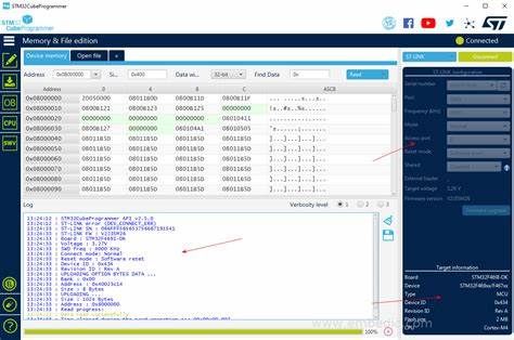

Hi @neuberfran​,
You can use STM32CubeProgrammer tool.
Imen
Thanks
Imen
neuberfran
@Imen DAHMEN​
You still haven't answered the main question I asked above: Why when I move the potentiometer Isn't it changing anything in the value of the dma-adc variable in debug? (Because in the video it works ok.)
@Imen DAHMEN​
This image is really bad, I can't even see it with zoom
