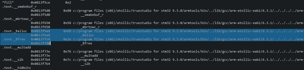

I'm developing a firmware for an STM32F767 and I have a problem that happens randomly and I can't figure out why. From what I could analyze looking at the stack I think the problem comes when doing a sprintf and I have the hypothesis that it could be an overflow problem.
According to the fault analyzer, when the error is caught I have this context:
Hard Fault Details: Bus, memory management or usage fault (FORCED)
Bus Fault Details: Precise data access violation (PRECISERR) BFAR: 0x30333531
Register Content During Fault Exception:
  • sp(PSP): 0x20013480
  • r0: 0x30333531
  • r1: 0x0
  • r2: 0x18
  • r3: 0x20040fe0
  • r12: 0x819bc400
  • lr: 0x813dc81
  • pc: 0x813f6fa
  • xpsr: 0x2100000
It is curious since the BFAR and r0 register contains part of the value to be formatted by sprintf (the number is 15300), which further strengthens the hypothesis that there may be an overflow problem somewhere.

Look at disasm at and before address pc: 0x813f6fa . Which function is it in?
Do you use RTOS? If yes, don't use printf(), it's not reentrant. (I mean, generally, using printf() in microcontrollers is something which should be considered twice and then rejected).

Hi wacakwek.jan,
thank you for you comments. The fault fall between Balloc and Bfree functions (see picture)
_legacyfs_online_stmicro_images_0693W00000dDgdHQAS.pngI'm using FreeRTOS with #define configUSE_NEWLIB_REENTRANT 0 because I'm using C standar library (no newlib). Analyzing the Call Stack, what I undertand is the standard C library is using reentrant functions since the most of them have the "_r" ending.
0x0813DC89 - _dtoa_r (Where the fault is triggered)
0x0813F702 - _Balloc
0x0813FD27 - __2db
0x081404D3 - __ssprint_r
0x0813A6B5 - __ssvfscanf_r
Do you suggest use any alternative to format float values without using the standar library?
Best regards
When printing floats, printf does use malloc as @TDK​ mentioned. And malloc() is not re-entrant unless you take specific steps to make it so (newer versions of CubeMX/IDE make this easier but not foolproof). So malloc() is probably the failure point as @Community member​ said.
Even though you see the functions with trailing _r, if you don't define configUSE_NEWLIB_REENTRANT then FreeRTOS doesn't make space for the reentrant structure in its task blocks (I think - need to verify this). No matter WHICH library you are using (clib or newlib).
[EDIT] And using floating point in multiple tasks has its own set of pitfalls.
I agree with you that the problem probably comes when doing a malloc when trying to printf a float value. @Community member​  link is very interesting, I think it's vitally important to apply the changes he mentions so that the system is consistent.
In addition, after review a project configuration I was wrong (and a litle confused) and it is using newlib library. Then, as you said, I need config FreeRTOS with configUSE_NEWLIB_REENTRANT to work properly with reentrant structs.
