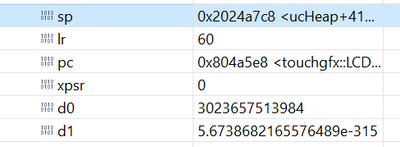

I am using STM32U5A9 processor from built-in RiverDI 5 inch display. I was able to see the Fault Analyzer's BusFault address, but I could get anything from that address in the memory view. All the data was in ?????
When I debugged further, I saw like this in the debugger.

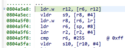

Disassembly hit in this command:

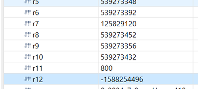

When I checked the registers r6 and r12, r12 seems to be an invalid memory location:
