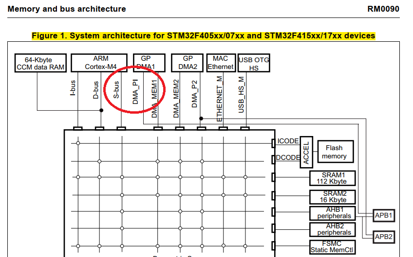

studying the DMA of the STM32F407 MCU, I came across Figure 1: System architecture.
It says DMA_PI for GP_DMA1 but DMA_P2 for GP_DMA2.
I reckon that DMA_PI is a simple typo and should be called DMA_P1 and stands for the DMA peripheral bus.
Would you agree? Any ST employee here that can confirm it?
Thank you,

Push. :) Are there no ST employees in this forum that can give a quick feedback?

Hi @Community membernthon​ ,
I am here :) to confirm that this is a typo and I report it internally.
Thanks for bringing it to our attention.
-Amel

Hello @AAnth.1 ,
This typo is fixed in RM0090 Rev 19.
Thank you.
