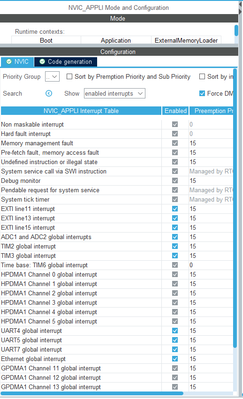

This is my application NVIC:
I set everything to 1 except the not editeble interrupt handlers as wel as TIM6. Upon running, HAL_GetTick still return 0 all the time, as uwTick is not increasing.
That screenshot shows systick is lower priority than everything else.
Put TIM6 at 0 and everything else at 15.

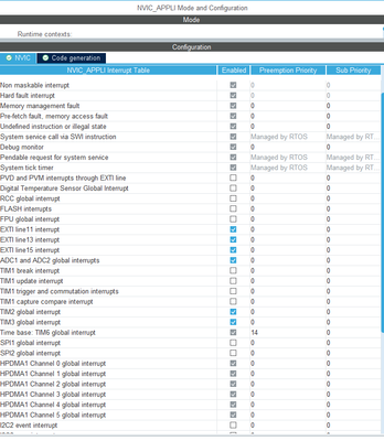

htxy
To catch and prove that uwTick is not increasing, I have written a HAL_Delay(10) after HAL_Init(). The expected behaivior to proof that uwTick is not increasing is a "infinite loop".
That is also exactly what happened.
Also here is the NVIC i used.

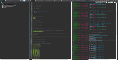

htxy
Very interesting that you pointed that out.
I had to regenerate the code due to the change of the change of the NVIC priorities. Interesting thoug, not only is there no TIM6_DAC_IRQHandler to be found anymore.
Sadly i didnt have version control enabled...
I also appended the IOC file.
Also i recorded a video how the SFR values for TIM6 change, but upon inspection the variables, they change from beeing uninitialized to receiving 0 as value, as if uwTick isnt getting TIM6 as reference.
