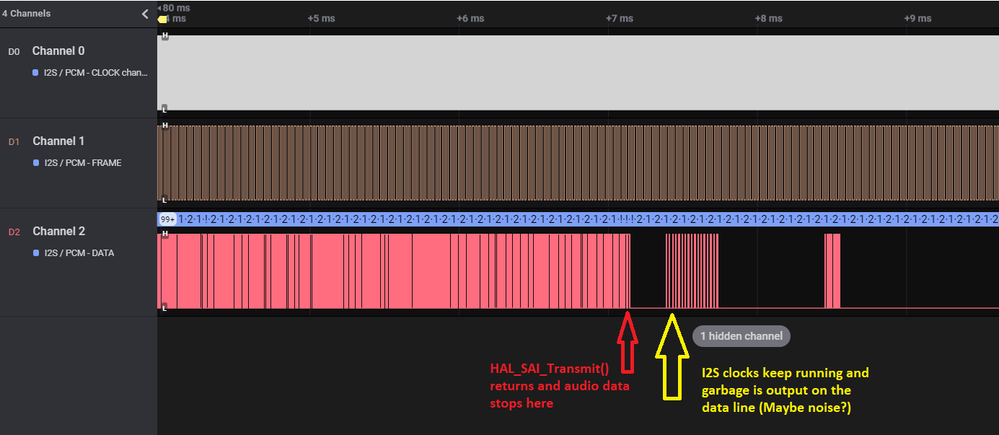

I am currently debugging external DAC audio issues. I reverted to using simple SAI blocking functions for testing purposes. In doing so, I have discovered that HAL_SAI_Transmit() keeps all I2S clocks running after the specified amount of data is transmitted.
Question 1: Are the I2S clocks supposed to stop after HAL_SAI_Transmit() returns, or is it up to the user to call __HAL_SAI_DISABLE() to stop the clocks manually?

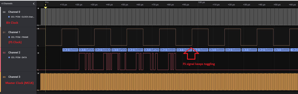

My concerns is with the statement "However FS signal generation is
conditioned by the presence of data in the FIFO". Looking at a logic analyzer, I see the FS signal (or WCLK) always toggling even after the FIFO is flushed onto the I2S bus. See screenshot below:
Question 2: Is this a bug in the STM MCU / driver, or is the reference manual incorrect?

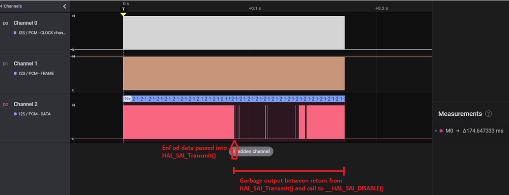

I am attempting to transmit a small portion of an audio file as a test. The audio file is 44.1 KHz, stereo (2 channels), 16-bits per channel. Since the clocks keep running after HAL_SAI_Transmit() returns, garbage is sent to the DAC on the data line beyond the end of the specified buffer length as seen below:
Question 3: If the clocks do keep running after HAL_SAI_Transmit() returns, why am I seeing garbage output on the data line instead of 0x00 as defined in the reference manual? Is the only explanation that it could be coupling to the other clock lines and picking up noise?
Edit: I tried calling __HAL_SAI_DISABLE() after HAL_SAI_Transmit() returns and some garbage data is still output before the SAI clocks actually stop as seen below:
Interestingly the garbage data looks the same across multiple captures so this makes me think the SAI driver / hardware is incrementing beyond the end of the transmit buffer and outputting random data from RAM. I have verified the 'Size' value passed into HAL_SAI_Transmit() is the length of my buffer so I don't see why data beyond this would be output.

> FS signal generation is conditioned by the presence of data in the FIFO
This wording is cumbersome but IMO it means that FS won't start until first data are written, but then remains toggling indefinitely.
I don't know what are the data you see, I wouldn't expect SAI to release the data line until disabled.

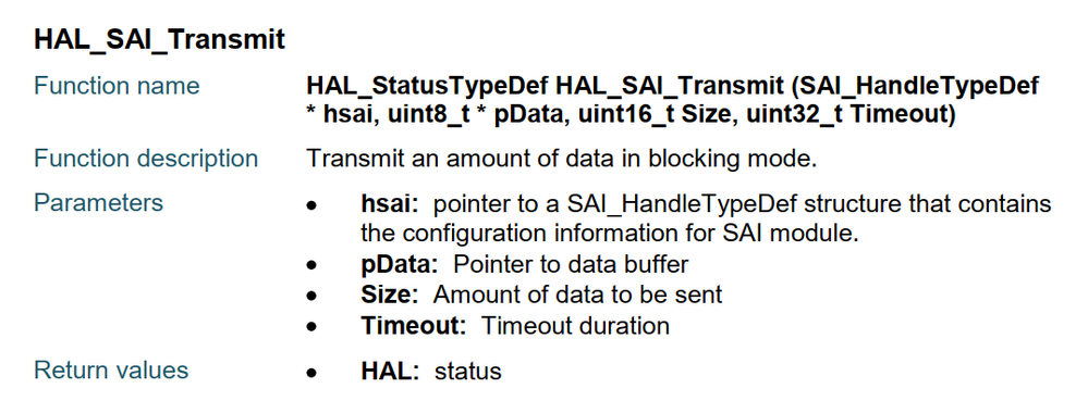

Hello @Community member​ ,
According to the HAL API document:
Based on this description, HAL_SAI_Transmit() will "Transmit an amount of data in blocking mode" where Size: Amount of data to be sent.
Looking at the logic analyzer, more than "Size" bytes are output on the bus. According to the STM32L4R9 reference manual: "If there is no data to transmit in the FIFO, 0 values are then sent in the audio frame with an underrun flag generation."
So I would expect the data line to be held low after HAL_SAI_Transmit() transmits all bytes. Instead, garbage (random data) is being output. I guess I will start debugging the HAL SAI driver...
Thanks,
