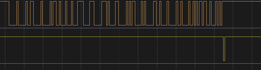

Hi there,
I am using two STM32H723ZGT communicating via FDCAN2 instance (FDCAN, no bit rate switch, 12500 bit/s). Both controller use the same FDCAN initialization code, but different filter IDs.
As shown below, the message is transfered on receiver CAN_Rx (upper trace) and acknowledged on sender CAN_Rx (lower trace), but neither the HAL_FDCAN_RxFifo0Callback() nor HAL_FDCAN_RxFifo1Callback() is triggered. When the receiver is shut down, the ackowledge disapears, so the message seems stuck in the the CAN peripherial.
FDCAN messageFDCAN message
CAN instance 1 (CAN2.0) is used for communication with other periperhial devices an works as expected.
What am I missing?
Thanks in advance!

I don't see HAL_FDCAN_Start?
If a reply has proven helpful, click on Accept as Solution so that it'll show at top of the post.CAN Jammer an open source CAN bus hacking toolCANableV3 Open Source
PGrif.2
PGrif.2Author
February 21, 2024
Hi Karl,
HAL_FDCAN_Start(&hfdcan2) is called right after CAN_ConfigCAN02FilterByAddress().
If wouldn't had been called no acknowledge bit would be visible.
Cheers.

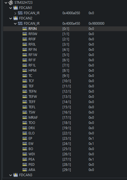

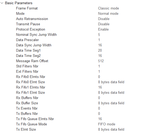

PGrif.2
PGrif.2Author
February 21, 2024
Hi SofLit,
I am using two CAN channels.
Channel 1 H723 A to L432 C
Channel2 H723 A to H723 B
Channel 1 is FDCAN1 in classic format to communicate with a STM32L432 supporting only CAN2.0 (classic) at 20kbit/s.
Channel 2 is FDCAN2 in FDCAN format to communicate with another STM32H723 supporting FDCAN at 12.5kbit/s.
I want to use both channels simultaneously (A - C and A - B) and take advantage of the higher data size of FDCAN, my understanding is that all 3 FDCAN instances are fully independend.
Changing FDCAN2 to classic as recommended shows the same behaviour at receiver B, just an CAN acknowledge no interrupt at the register:
FDCAN 2 classicFDCAN 2 classic
FDCAN2 interrupt registerFDCAN2 interrupt register
FDCAN2 classic settingsFDCAN2 classic settings
 Cheers.
