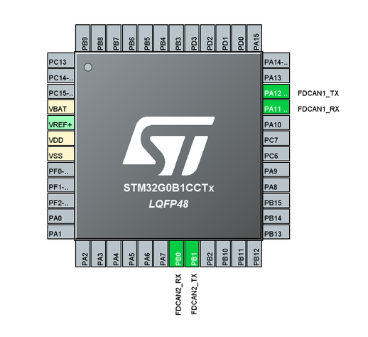

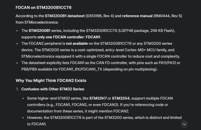

My question is that stm32g0b1cct6 have fdcan2 or not because i getting confuse i read many document and reference some are said that stm32g0b1cct6 is low budget mcu and its have only fdcan1 not fdcan2 . so dear support team plz response fast

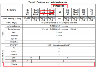

Hello @Vika43121,
This information is something that you can find in the datasheet of the product, especially the table "Features and peripheral counts":
So stm32g0b1cct6 has two FDCAN instances.

It seems to have 2 FDCAN peripherals
and this person is using FDCAN2 for the bootloader
