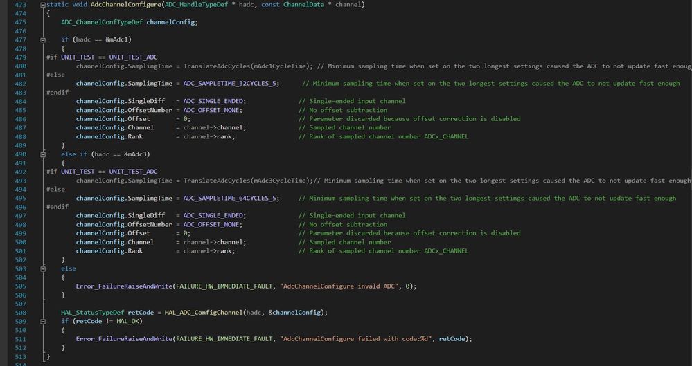

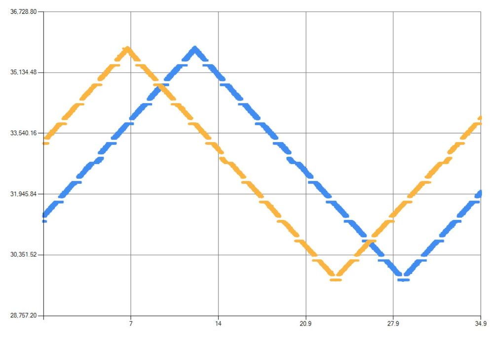

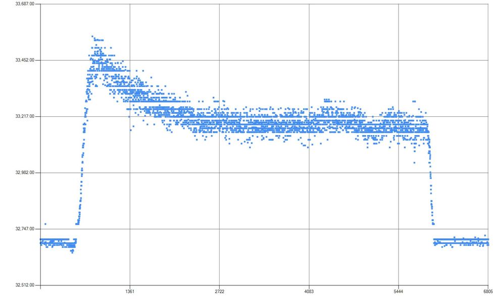

We are using ADC 1 and 3 to capture analog pressure sensor readings. We observed a gapping phenomenon in the output data where the ADC failed to output data in specific ranges consistently.
We discovered that using the ADC_CALIB_OFFSET was incorrect and switched to ADC_CALIB_OFFSET_LINEARITY. We also calibrate every power cycle and account for temperature drifts. Despite all of this, on approximately 25% of the units we still see this gapping with the same version of firmware.

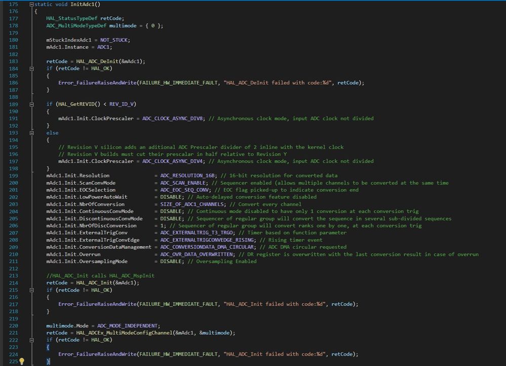

Update:
  • An ADC kernel clock of 2Mhz appears to induce this phenomenon. When I increase the kernel clock via the dedicated PLL up to 100Mhz, this gapping issue appears to resolve itself almost entirely. Thoughts? It was my understanding that the getting started manual recommended an ADC kernel clock of <= 25Mhz

Sampling time is set to 32.5. I have tested with other sampling cycle counts as well. If I am asking for conversion faster than it can serve, I will see my sampling rate decrease as it takes longer to convert.
