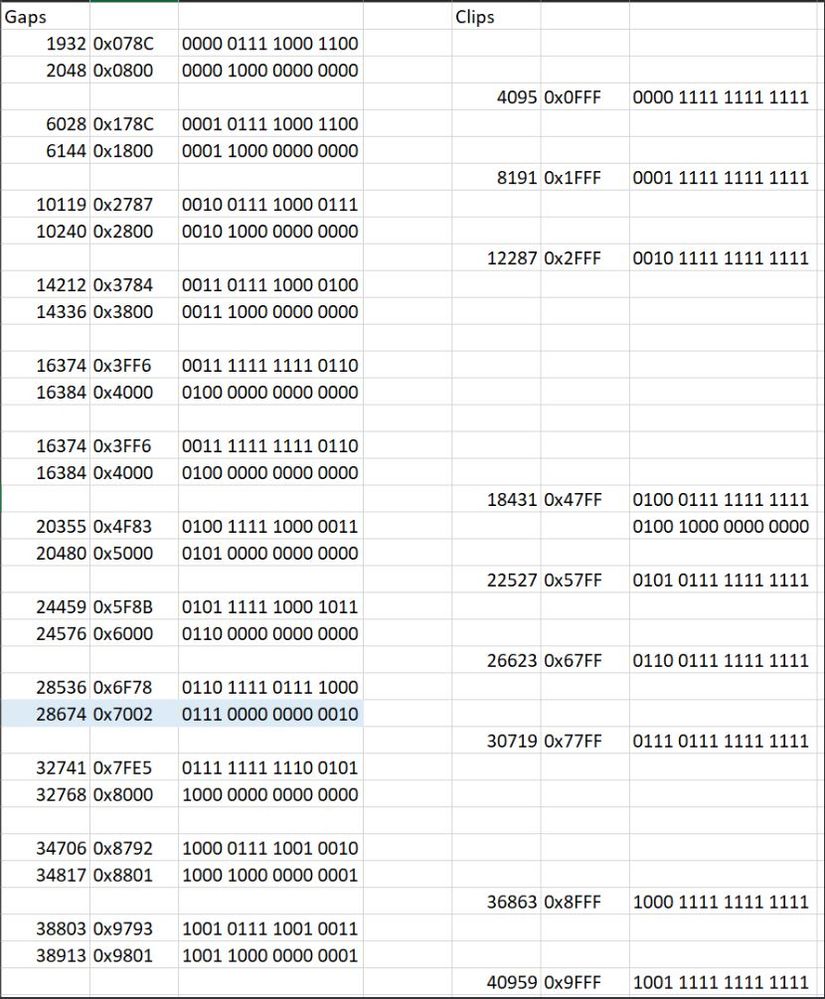

And the explanation of the process issue is that a slow clock speed could allow some of the capacitors of the SAR to discharge before the comparison and DAC operations are performed? I'm trying to get to an explanation of how the process fails. The gaps manifest in powers of 2 and happen when the least 4-8 significant bits are all ones and the next most significant bit jumps from a 0 to a 1.

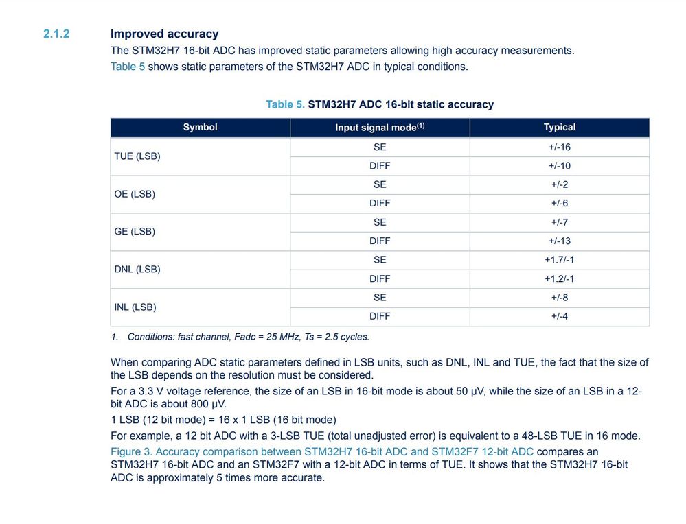

DNL is +3/-1 LSB. IMHO, I'd not expect great accuracy out of internal ADC, that is running in hostile uCPU digital environment.
Solution could be external IC or dithering+averaging LPF-ing.
Here is a screenshot of the DNL for the 16 bit ADC. I am seeing +1.7/-1. I am assuming this means you can have a swing of +/- 2LSB worth of data. That doesn't seem to add up to the gapping we are seeing. Or am I misreading this? We don't need absolute accuracy, we just need to overserve all of the codes without gaps.
Here is a spread sheet of when/where the gaps and clips occur. The numbers under the gaps are the minimum and maximum values around a gap. As in, the low number is the bottom of the gap and the larger number is the top side of the gap. This data was generated using a function generator and applying a triangle wave (see image in original posting).
