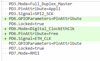

In my project for an STM32H7S3, I'm using the Ethernet module, and it works fine.
However, I don't need the ETH_CLK pin. In RCC settings, there's an option which suggests I can turn it off; however, clicking the tickbox has no effect. (Note also that the text for this option is "Digital clock input" - even though the pin is an output.)
Instead, I can set the pin itself to its Reset state, and that works. However, next time I open the IOC file, that setting is missing, and I have to change the pin state again. In addition, if I save the IOC file without making any changes at all, I can see in the diff that the settings for that pin have been changed:
Previously, the generated value of ETH_CLK was outside its valid range (HSE was too low, and any setting from PLL3S was too high), and even though I wasn't using it, Cube wouldn't let me generate code without disabling this pin, because ETH_CLK is an input to the ETH Clock Mux, and presumably all inputs to this mux must be valid even though I wasn't using ETH_CLK. Since then, I can now generate a valid signal from PLL3S, but again, it should be irrelevant, as I'm not using ETH_CLK.
So to summarise:
  1. I'd like the tickbox to disable ETH_CLK to work.
  2. When disabled instead via pin settings, I'd like this setting to be remembered.
(See also another post by me about settings being lost without any action on my part.)
I'm currently using Cube 6.15.0, though this file was created with an earlier version.
I'm not willing to share my IOC file here, though I'd be happy to send it privately to someone at ST.
Thank you.

Hello ST-Support-Team,
I discovered the same problems with the ETH_CLK pin as the thread opener. I'm not able to disable the pin properly. I need this pin as GPIO input, but my settings are overwritten as soon as I close and re-open the project again.
I created my project with STM32CubeMX V6.14.1 for an STM32H7S7I8T.
Do you have any information when this bug will be fixed?
