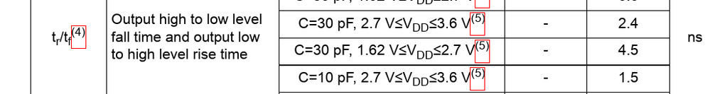

the pins are fast, here from H743 data:
0693W00000aJFp6QAG.png2ns should be possible.
to see 50MHz square, need fast scope and probe - what you use here ?
