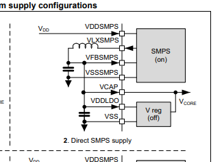

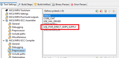

Your project is configured in SMPS:
The definition is in your IDE project is well set to Direct SMPS:
Most probably your issue is in your hardware. Need to ensure first your board is hardwired in Direct SMPS.

Need to ensure you have the same hardware configuration as of Nucleo-H755ZIQ on your custom board. So the first question comes here: what is the power configuration you have on your custom board? Direct SMPS? LDO?
Nucleo-H755ZIQ board is Direct SMPS configuration by default. So if your board is not in direct SMPS by hardware, you've locked your MCU and you need to unlock it.
Please read: How can I recover my STM32H7/STM32H7RS board after facing a power configuration deadlock?

I am using a direct SMPS power supply on the custom board. I have a doubt — is there any chance that the startup code is different between the custom board and the development board?NO RIGHT
