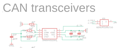

‎2025-05-14 12:32 AM - edited ‎2025-05-14 12:42 AM
Hello @uti_prakash and welcome to the community,
First, please use </> button to paste your code. Please refer to this post: How to insert source code.I''m editing your post.
Second, as you are using Normal mode,
hcan1.Init.Mode = CAN_MODE_NORMAL;
are you establishing a complete CAN bus as the following i.e. connecting a second node on the bus?
As per your comment, I suspect it's not the case:
@uti_prakash wrote:I'm planning to communicate with another STM32 board (L432KC) using CAN, but I need to get the basic transmission working first.
If not, that's not the correct way to use CAN in normal mode.
So either use a second node with the minimal hardware as shown above or use Loopback mode where you can use only one device. CAN is not SPI or UART.
If you are establishing a complete CAN bus please provide more details on the hardware used especially how you did establish a CAN bus.
For Loopback mode please read this article: Guide to CAN (bxCAN/CAN2.0) configuration in Loop back mode on STM32 MCUs
PS: better to attach your ioc file instead of sharing screenshots.
‎2025-05-17 12:22 PM - edited ‎2025-05-17 12:24 PM
Hello mÆŽALLEm. Thanks for clarifying the difference between CAN and other communication protocols. I want to let you know that I have a custom dev-board consisting of Teensy 4.0 as the other node, which I plan to use as a recipient (instead of L432KC) for simplicity, of whatever I want to send through the F446RE nucleo board. I have shared the .sch screenshots of the dev board for context. I am using SN65HVD250 as CAN transceivers. I request that you guide me in setting up my nucleo in the NORMAL mode of operation. I have tried to look up online for some tutorials, but everything seems confusing to me. I have attached the .ioc file as per your suggestion. I am a novice in CAN communication, so if you could provide some material related to CAN theory, it would mean a lot.

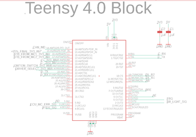

‎2025-05-19 2:46 AM
What's that "Teensy 4.0" dev board? does it contain a CAN transceiver?
Please post a sketch of your CAN bus with the two nodes: Nucleo F446RE + the transceiver + Teensy 4.0 + its transceiver + the two 120 ohm terminating resistors as indicated in my previous post.
I need a clear view of your environment to help you efficiently.

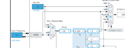

+ It's not recommended to use HSI for the CAN communication in Normal mode. You need an accurate clock source such as a crystal.
What I suggest is to use the STLINK MCO output and configure the HSE in Bypass mode. I've attached the ioc file where I updated the RCC.
