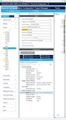

PWM Output (TIM2_CH1):
The PWM output is generated on PE0:
Notes:
TIM2 configured for PWM mode 1
Channel 1 is used
Output routed to PE0 (verified)

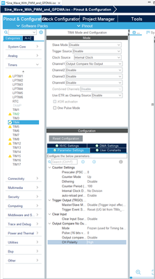

TIM4 Configuration(To Operate in OC Mode On CH1):
Here is how TIM4 is configured:
Note:
Number 100 according to the guide (will be replaced in the code).

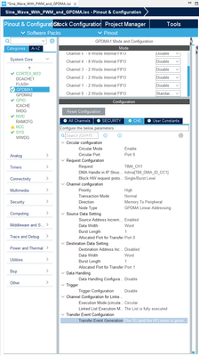

GPDMA Configuration:
Here is how I configured GPDMA1 Channel 0:
Notes:
Source Increment: Enabled
Destination Increment: Disabled
Mode: Circular
Request Source: TIM4_CH1
Direction: Memory-to-Peripheral

DMA_NodeTypeDef Node_GPDMA1_Channel0;
DMA_QListTypeDef List_GPDMA1_Channel0;
DMA_HandleTypeDef handle_GPDMA1_Channel0;

  HAL_DMA_Start_IT(&handle_GPDMA1_Channel0, (uint32_t)Wave_LUT, DestAddress, NS);
  __HAL_TIM_ENABLE_DMA(&htim4, TIM_DMA_CC1);

static void MX_TIM2_Init(void)
  /* USER CODE BEGIN TIM2_Init 0 */
  /* USER CODE END TIM2_Init 0 */
  TIM_ClockConfigTypeDef sClockSourceConfig = {0};
  TIM_MasterConfigTypeDef sMasterConfig = {0};
  TIM_OC_InitTypeDef sConfigOC = {0};
  /* USER CODE BEGIN TIM2_Init 1 */
  /* USER CODE END TIM2_Init 1 */
  htim2.Instance = TIM2;
  htim2.Init.Prescaler = 0;
  htim2.Init.CounterMode = TIM_COUNTERMODE_UP;
  htim2.Init.Period = 1023;
  htim2.Init.ClockDivision = TIM_CLOCKDIVISION_DIV1;
  htim2.Init.AutoReloadPreload = TIM_AUTORELOAD_PRELOAD_ENABLE;
  if (HAL_TIM_Base_Init(&htim2) != HAL_OK)
    Error_Handler();
  sClockSourceConfig.ClockSource = TIM_CLOCKSOURCE_INTERNAL;
  if (HAL_TIM_ConfigClockSource(&htim2, &sClockSourceConfig) != HAL_OK)
    Error_Handler();
  if (HAL_TIM_PWM_Init(&htim2) != HAL_OK)
    Error_Handler();
  sMasterConfig.MasterOutputTrigger = TIM_TRGO_RESET;
  sMasterConfig.MasterSlaveMode = TIM_MASTERSLAVEMODE_DISABLE;
  if (HAL_TIMEx_MasterConfigSynchronization(&htim2, &sMasterConfig) != HAL_OK)
    Error_Handler();
  sConfigOC.OCMode = TIM_OCMODE_PWM1;
  sConfigOC.Pulse = 0;
  sConfigOC.OCPolarity = TIM_OCPOLARITY_HIGH;
  sConfigOC.OCFastMode = TIM_OCFAST_DISABLE;
  if (HAL_TIM_PWM_ConfigChannel(&htim2, &sConfigOC, TIM_CHANNEL_1) != HAL_OK)
    Error_Handler();

  htim4.Instance = TIM4;
  htim4.Init.Prescaler = 0;
  htim4.Init.CounterMode = TIM_COUNTERMODE_UP;
  htim4.Init.Period = TIM4_Ticks-1;                 // <---- This Line
  htim4.Init.ClockDivision = TIM_CLOCKDIVISION_DIV1;
  htim4.Init.AutoReloadPreload = TIM_AUTORELOAD_PRELOAD_ENABLE;
  if (HAL_TIM_Base_Init(&htim4) != HAL_OK)
    Error_Handler();
  if (HAL_TIM_ConfigClockSource(&htim4, &sClockSourceConfig) != HAL_OK)
    Error_Handler();
  if (HAL_TIM_OC_Init(&htim4) != HAL_OK)
    Error_Handler();
  if (HAL_TIMEx_MasterConfigSynchronization(&htim4, &sMasterConfig) != HAL_OK)
    Error_Handler();
  sConfigOC.OCMode = TIM_OCMODE_TIMING;
  if (HAL_TIM_OC_ConfigChannel(&htim4, &sConfigOC, TIM_CHANNEL_1) != HAL_OK)
    Error_Handler();

Tzahi14
I want to share how I solved this problem.
Because I work with GPDMA, I replaced this command:
With this command:
  if (HAL_DMAEx_List_Start_IT(&handle_GPDMA1_Channel0) != HAL_OK)
      Error_Handler();
I set these parameters: Wave_LUT(uint32_t), DestAddress, NS,
in GPDMA initialization, but it is not in the main.c file as explained here.
So, in the stm32h5xx_hal_msp.c file I defined it as follows:
extern DMA_NodeTypeDef Node_GPDMA1_Channel0;
extern DMA_QListTypeDef List_GPDMA1_Channel0;
extern DMA_HandleTypeDef handle_GPDMA1_Channel0;
extern uint32_t Wave_LUT[128];
And:
NodeConfig.DstAddress = (uint32_t)&TIM2->CCR1;
NodeConfig.SrcAddress = (uint32_t)Wave_LUT;
NodeConfig.DataSize = 128;
Attention, they must be defined before "HAL_DMAEx_List_BuildNode..." !!
Hope this helped someone, good luck!
Thanks.
Tzahi
