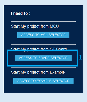

We need to start a project based on the board in STM32CubeMX:
  1. Create a new project starting from the “ST board”
  2. Select the [Access to board selector]
  3. Find the board “NUCLEO-F103ERE”
  4. In the bottom right of the window, double-click on the board image.
Figure 1. Start a project based on a ST boardFigure 1. Start a project based on a ST board

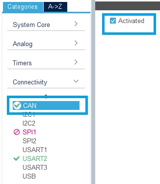

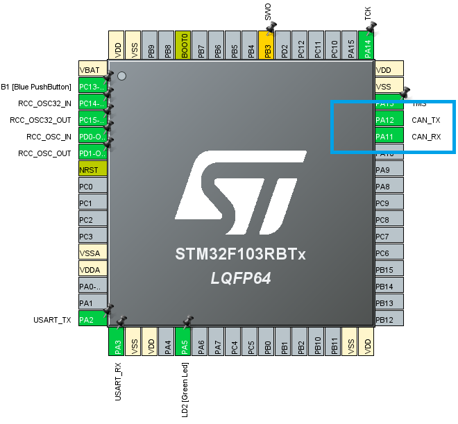

The first thing to do is to enable CAN1 from the “Connectivity” menu:
Figure 5. CAN activationFigure 5. CAN activation
Figure 6. CAN pins activatedFigure 6. CAN pins activated

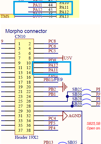

After enabling CAN1, PA11 and PA12 GPIOs are enabled by default for this product. There were no conflicts between the already enabled GPIOs on the board and the CAN Ios. This is confirmed by looking at the board’s schematic, PA11 and PA12 are free, and nothing connected to them. So, these GPIOs can be used for the CAN application.
Figure 7. CAN pins on the board are freeFigure 7. CAN pins on the board are free
After the CAN interface activation, there are three stuff to configure: the clock configuration, the CAN timing configuration and the GPIO configuration.

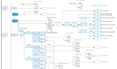

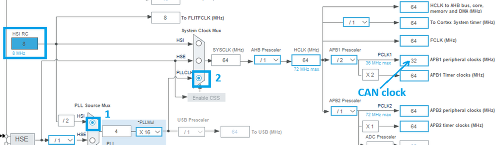

2.3 Clock configuration
As the Loop back mode is used, there is no need for a precise clock source because the bit sampler and the bit generator have the same clock source. So, HSI is used as the clock source in the example. In the case of STM32F103, the CAN peripheral is clocked from the APB1 domain as stated in the reference manual:
Figure 11. The CAN clock is on APB1 domainFigure 11. The CAN clock is on APB1 domain
So, the CAN bit time is generated and sampled based on this clock source.
In STM32CubeMX, we select an HSI clock source over PLL. The system clock source is 64 MHz and the APB1 clock is be 32 MHz (the maximum).
In STM32CubeMX, in “Clock Configuration view”:
  1. Select HSI clock source (8MHz/2)
  2. Select PLLCLK to enable the PLL
Figure 12. System clock configurationFigure 12. System clock configuration

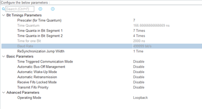

2.4 CAN timing configuration
In this example, we set the CAN bitrate at 500 KB/s. Knowing that in the Loop back mode, the bitrate configuration is not a must. The CAN bit time configuration applies for both Tx and Rx and the transmitted messages are received at the same CAN bitrate.
Take precaution. Setting BS1 and BS2 to very low values such as BS1=1 and BS2=1 leads to a communication issue. Better to decrease the CAN clock prescaler and increase BS1 and BS2 as much as possible fitting the CAN bitrate.
In STM32CubeMX, in “Parameter Settings”, the default timing config values set are:
  • Prescaler = 16
  • Time Quanta in Bit Segment 1 = 1
  • Time Quanta in Bit Segment 2 = 1
These are not ideal settings.
Figure 13. Default CAN timing configuration in STM32CubeMXFigure 13. Default CAN timing configuration in STM32CubeMX
The first thing to do is to increase BS1 and BS2 to their maximum values (BS1=16, BS2=8) in STM32CubeMX. Decrease the prescaler step by step until the CAN bitrate target value is found. If the operation does not allow to converge to the wished exact bitrate, try to play with the prescaler.
As said, in our example the CAN bitrate is set to 500 KB/s. The sample point needs to be selected between 75% and 87% of the bit time.
In STM32CubeMX, we choose these settings:Figure 14. CAN timing configurationFigure 14. CAN timing configuration
The bit time = SyncSeg + BS1 + BS2. In our case, the bit time = 1 + 12 + 3 = 16
Where SyncSeg is always = 1.
The sample point = (SyncSeg + BS1) / bit time = (1 + 12) /16 = 0,8125 à Sample point at: 0,8125%
In this configuration, the sample point is set at ~81% of the bit time.

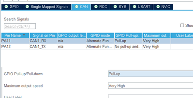

2.5 CAN GPIO configuration
Even if the CAN signals are internally connected by hardware, it is mandatory to configure the I/Os. This is already done when CAN is activated in STM32CubeMX as shown in the figures 5 and 6. To avoid issues, we need to activate the internal pull-up resistor manually on the CAN_Rx pin.
In that case, we need to go to the “GPIO settings” tab and set the pull-up on CAN_Rx pin which is PA11 in this case.
In STM32CubeMX, go to the “GPIO Settings” tab, and:
  1. Click on the CAN_RX pin
  2. Go to the PA11 configuration then to “GPIO Pull-up / Pull-down” and select [Pull-up] to set the internal resistor.
Figure 15. Setting the pull-up on CAN_Rx pinFigure 15. Setting the pull-up on CAN_Rx pin

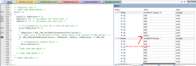

Now, it is time to add the code responsible for the CAN transmission in the while loop. Note that we need to check first if there is one Tx mail box available to send the current CAN frame. Otherwise, HAL_CAN_AddTxMessage() returns an error if you do not wait until the previous frame is sent.
Some users put HAL_Delay(). It works but for efficiency reason, it is preferable to poll on the Tx free mail box.
The application transmits 8 bytes where the first byte (byte 1) is incremented, and the last byte (byte 8 is decremented.
Insert this code between while (1) { and /* USER CODE END WHILE */
	 TxData[0] ++; /* Increment the first byte */
	 TxData[7] --; /* Increment the last byte */
 /* It's mandatory to look for a free Tx mail box */
	 while(HAL_CAN_GetTxMailboxesFreeLevel(&hcan) == 0); /* Wait till a Tx mailbox is free. Using while loop instead of HAL_Delay() */
 if (HAL_CAN_AddTxMessage(&hcan, &TxHeader, TxData, &TxMailbox) != HAL_OK)
 /* Transmission request Error */
 Error_Handler();

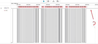

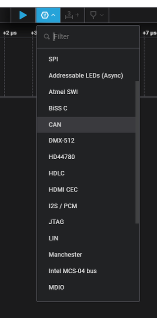

In this section, we show how to test the CAN in Loop back mode. For that we use the Saleae logic analyzer in CAN mode. We probe CAN_Tx (PA12). On NUCLEO-F103 the connector pin CN10/12 is used.
Connect the GND of the logic analyzer to the GND of the board and connect the data 0 (D0) of the logic analyzer input to CAN_Tx (PA12).
In the Saleae logic analyzer software interface, enable the digital channel 0. Go to the analyzer menu “Add Analyzer” and search for “CAN” and select it.:
Figure 20. Configure the Saleae logic analyzer digital channel 0 input in CAN modeFigure 20. Configure the Saleae logic analyzer digital channel 0 input in CAN mode

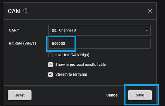

A window is shown to configure the CAN bitrate. In our case 500 KB/s is used. Set the value to 500000 (in Bits/s) and click [Save]:
Figure 21. CAN configuration with Saleae logic analyzerFigure 21. CAN configuration with Saleae logic analyzer
Now, connect the board to your PC/laptop with a USB data cable over STLINK USB connector and in STM32CubeIDE, start a debug session:

In the logic analyzer, click the [Start] button to start the frame capture.
Now, run the application from STM32CubeIDE by clicking the green triangle:
Figure 24. Running the application on STM32CubeIDEFigure 24. Running the application on STM32CubeIDE
The logic analyzer starts capturing the CAN frames sent on CAN_Tx pin (PA12).
These are the frames captured by the logic analyzer:
Zoom out of the capture:
Figure 25. Zoom-out of the CAN frames captured by the logic analyzerFigure 25. Zoom-out of the CAN frames captured by the logic analyzer
In the first frame sent by the application, the analyzer indicated that the frame ID is 0x123. The first byte sent in the frame is 0x01 and the last data sent is 0xFE. Which corresponds well to what the application is doing.
Figure 26. Zoom-in on the first CAN frame sent by the STM32 and captured by the logic analyzerFigure 26. Zoom-in on the first CAN frame sent by the STM32 and captured by the logic analyzer
Note that the pulses related to the zeroed data correspond to the bit stuffing.

I'm in a NUCLEO F446RE and the communication is stopped after a few messages:
I debugged the code and I found the reason is because
HAL_CAN_GetTxMailboxesFreeLevel is returning 0 after successfully send a few messages:
My thinking is that it has to do with the clock configs, since this tutorial does not show what we need for the F446RE, so I'll try modifying those.
Thanks for reading.

About the mode, I m using Loopback mode, I followed these same steps but the clock config since they are different for the NUCLE F446RE.

Since you are using the Loopback mode, don't care a lot about the clock configuration. You can use any clock configuration and any CAN bitrate.
Check if you configured the internal pull up resistor on the CAN1_Rx pin:

It is.
