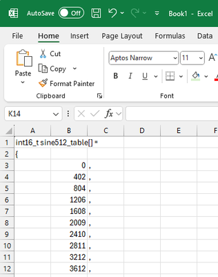

‎2024-07-26 3:09 AM - edited ‎2024-07-26 3:11 AM
@gregstm wrote:When I generate table data, I tend to use an assembly language routine, not really for speed, just because I find it neater/easier to layout the data
Really?
As @Tesla DeLorean , a C array seems easier & neater to me:
int16_t sine512_table[] =
0,
402,
804,
1206,
1608,
2009,
2410,
2811,
3212,
3612,
etc ...
You can do it directly in the spreadsheet - just Save As text:
EDIT: commas!
