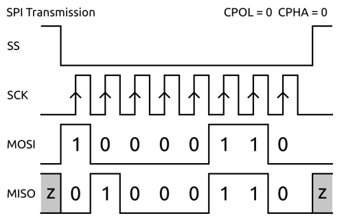

Consider a typical SPI data transmission
Now ignore everything but the MOSI line. If you send 0b10000110 to a SPI peripheral, you will get the above waveform on the MOSI line. The timing of the signal is determined by the SPI baudrate. If you set the SPI baudrate to 1 kHz (each bit takes 1 ms), and send the following data sequence
{ 0x00, 0x00, 0x00, 0x00, 0x00, 0x00, 0x00, 0x00, 0x00, 0x00, 0x00, 0x00, // 96 zero bits
    0x08, 0x00, 0x00, 0x80, 0x00, 0x00, 0x02, ...
// 100 ^            120 ^              150 ^
you would get the beginning of the waveform that you want.
Note that most STM32 series offer a very limited range of possible SPI baudrates. Unless there is a dedicated PLL output for SPI or you are able to slow down the APB clock to a ridiculous frequency (which would slow down all peripherals on that bus), the lower limit of the SPI baudrate is usually 1/1024 of the system clock speed. Which means that on a 100 MHz system you'd need 100 bits data for every ms, 100*350/8 = 4375 bytes prepared for the whole cycle. You might have to send more consecutive 1 bits if the camera requires more time to recognize a trigger.
Also keep in mind that the level of the MOSI line can be high when it is not actively transmitting, so configure the pin initially as GPIO output, and switch to alternate mode only when SPI has started transmitting.
