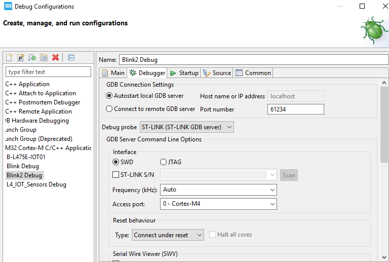

When I try to run a simple program on the board from ST32CubeIDE, I get the following error:
Error in initializing ST-LINK device.
Reason: ST-LINK firmware upgrade required. Please upgrade the ST-LINK firmware using the upgrade tool.
However I ran the ST-LinkUpgrade.exe tool several times, and can connect to the board easily using STM32 ST-LINK Utility.exe
I have no idea what this means
And you updated it to what firmware version? V2J36 is perhaps the most current
What version of STM32CubeIDE, and OpenOCD, etc?
DNeet.1
ST-LINK: V2.J34.M25
STM32CubeIDE: Version: 1.3.1
I'm using GDB-Server. Wherre can I find the Version No.?
DNeet.1
Thx for the advice. I updated to V2J36 and this is working now.
