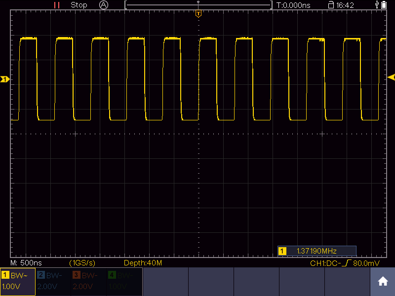

I initialized TIMER 1 to run from 137.5 MHz frequency. I set the prescaler = 0, the period = 100 and set channel 1 to toggle the output. I attached my scope probe to the TIMER 1 channel 1 output pin (PE9, CN10.4) and I measured the frequency . It was anything between 1.371 and 1.373 MHz, instead of 1.375 MHz. It was very unstable.
0693W00000Kd2i8QAB.bmpStill no comment?

waclawek.jan
I've told you already that STLink3's 8MHz output is not derived from crystal (which means it's derived from its HSI). And your symptoms confirm it. What's the point of your repeated posts, then?
And no, 'F723 used as STLink3 cannot generate 8MHz from 25MHz.
In CubeProgrammer you probably can switch STLink3's output to a different frequency, derived from the 25MHz crystal. I don't use CubeProgrammer nor STLink3. There are several related threads on this forum, search.

Peter BENSCH
Well, as @Community member​ wrote, the clock for the target STM32H723ZGT6 is fed from the MCO of the ST-LINK-V3E. The ST-LINK-V3E itself is driven by a STM32F723IEK6, in whose clock scheme the MCO outputs can only be fed from four sources and a divider 1:1...1:5 before the output: LSE, HSE, HSI and PLLCLK. Unfortunately, the (non-changeable) MCO frequency chosen for the ST-LINK-V3E is not the HSE, but 8MHz, which cannot be derived from the required PLLCLK, but only from the HSI.
So if you need a crystal stabilised clock on the STM32H723ZGT6, you must indeed could:
  • either assemble X3 and the load capacitors or
  • set the ST-LINK-V3E to HSE/3, i.e. 8.333MHz
