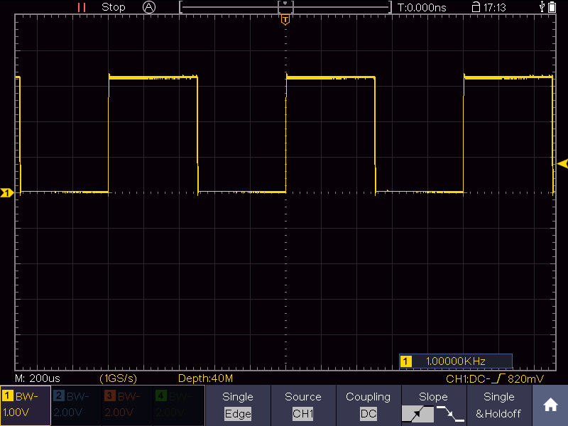

Louie88
Senior II
Hi Peter,
Does it mean, if I select the HSE/3 check box in Help -> Upgrade ST-Link dialog box (and upgrade the firmware of ST-Link) then I will get 8.333 MHz crystal based clock? If so, then I have to modify the PLL settings because with the current settings it would generate 572.9166 MHz clock.
Thanks,
Louis
Yes, correct.
Louie88
Senior II
Hi Peter,
It works! I have 1.00000kHz and the 5th digit is still stable.
But the 25MHz/3 = 8.333333MHz cannot be set only to #define HSE_VALUE (8333333UL) (in the stm32h7xx_hal_conf.h file) so all the HAL_RCC_GetXXXClock() functions return a bit faulty frequencies. I do not understand why the 25MHz is divided by 3. Dividing by 4 would be better. This is 6.25MHz and 352 * 6,25MHz / 4 would still generate 550MHz. The #define HSE_VALUE (6250000UL) would be accurate and all the HAL_RCC_GetXXXClock() functions return right clock. Consider for the V4 version.
Thank you for your and jan's help. You saved the project.
