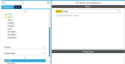

I have a NUCLEO-H723ZG board and I can confirm that the Ethernet was the cause of the extremely noisy ADC measurements in this case as well. After tombstoning the L1 ferrite bead (in case of H723 it is L1 and not L2) the noise was reduced drastically. I would just like to elaborate one more thing. When the project in CubeIDE is created and all peripherals with their Default mode is initialized, the Ethernet is enabled as well. So don't forget to disable Ethernet in CubeMX/CubeIDE besides disconnecting the ferrite bead, otherwise Ethernet wants to be configured and your firmware/application will get stuck.

Can you tell me how to disable the Ethernet in CubeIDE. I attached the screenshot of my try to disable it
