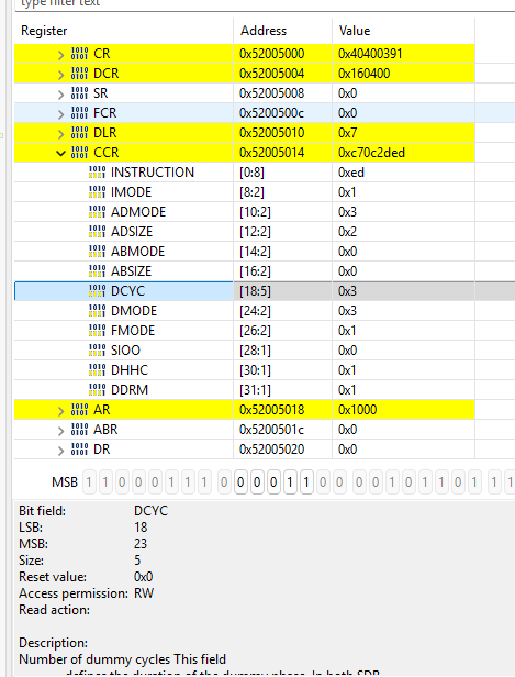

DCYC field in CCR register is 0x3, so there must be only 3 dummy cycles.

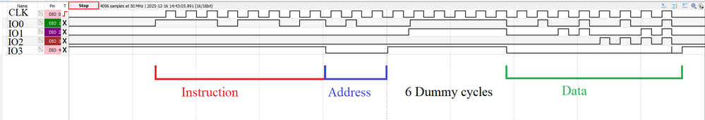

But on time diagram I can see 6 dummy cycles:
So I got 3 extra dummy cycles on STM32H743 board.
My question is: why there are extra dummy cycles? How should I calculate there number?

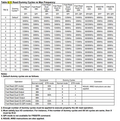

Hello @axlrose21 and welcome to the datasheet;
As mentioned in the memory datasheet, the number of dummy cycles depends on clock speed. Detailed information in Table 6.11 Read Dummy Cycles.
What is the QUADSPI frequency?
Thank you.
Kaouthar
axlrose21Author
December 22, 2025
Hello @KDJEM.1 !
I am using 615 kHz and 10 MHz frequencies for QSPI. My flash read register setting are P[6:3] = 0; (default dummy cycles count for Fast Read Quad IO command is 6).
