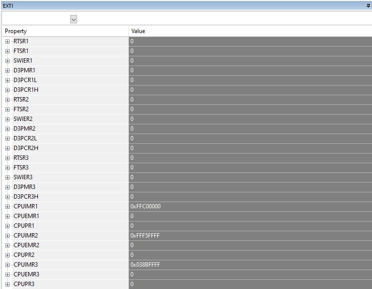

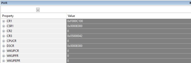

Still struggling with wakeup reason. Does anyone have an idea. Here is EXTI and PWR registers immediately after wakeup

The 'H7 is an overly complicated beast, and its EXTI is no exception. I don't use it, so following is only from reading the RM.
There are two kinds of EXTI signals - "configurable" and "direct", see EXTI Event input mapping table. Configurable are "legacy" and latch within EXTI in the Pending register(s) - that are all the "real" external interrupts from pins, for example.
Direct signals don't latch within EXTI, they just pass through resynchronization and are subject to gating (CPUIMRx registers, which by default are enabled for all Direct signals). So, for Direct signals, you are supposed to find trace at their source, based on what Wakeup interrupts have you enabled in the individual peripherals.
Also, if you use Cube/HAL, it's Cube/HAL which may get in your way by clearing the pending registers. Using Cube/HAL you agree to play along its own rules, written or not; and to accept its limited scope of "usual usage cases".
‎2021-09-30 4:53 AM
All peripherals are off at this point. So it is a "direct" event because I see nothing in CPUIMRx registers. Have no idea how to find a cause...
‎2021-10-01 7:30 AM
Clear all CPUIMRx registers. Still wakeup?
‎2021-10-04 6:43 AM
Yes, same
