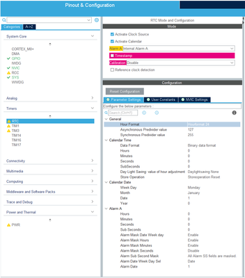

I've already changed the IOC so that "Alarm Mask Seconds" is alos enabled. Now it flashes once per second, not per minute. But how can I set a custom time? I tried playing around with the RTC Init but could'nt achieve a different timing.

‎2025-06-22 3:23 PM
I have re-read it and I think my question might be unclear. I want to set a custom duration for the alarm, so that foir example it will wake up after 5 seconds instead of 1.
‎2025-06-23 12:02 PM - edited ‎2025-06-23 11:13 PM
There is no RTC periodic alarm feature for arbitrary time intervals.
The RTC deals with absolute time & date like a wall clock. In general, you have to set the next alarm individually by setting all appropriate registers.
For shorter intervals of periodic wakeup I would recommend using the independent watchdog (IWDG).
hth
