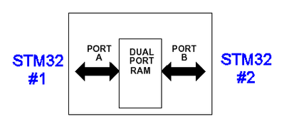

@KDJEM.1 wrote:
To enable high-speed communication between two STM32U5G9 chips, you cannot use OctoSPI or HexaSPI.
Unless you use a dual-port RAM ... ?
KDJEM.1
Hello;
As mentioned in this FAQ, the QUADSPI/OCTOSPI/HSPI/XSPI interfaces work only as masters. The interfaces do not support full duplex. Therefore, it cannot send and receive data simultaneously.
Thank you.
Kaouthar
