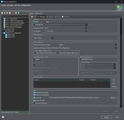

I've seen this issue in a few places. Some with solutions, none of which have worked for me. I am programming a Portenta H7 via a Portenta Breakout board with an ST Link v2 (please don't direct me to the Arduino forum. I have this conversation going over there as well).
CM4 DEBUGGER FAILS TO RUN
OR ST LINK IS FAILING TO CONNECT
In both projects, I start the CM7 debugger with no problems. When I start the CM4 debugger in either project, I get this error:
COM frequency = 4000 kHz
Target connection mode: Attach
Failed to read ROM table via AP 3
Error in initializing ST-LINK device.
Reason: Unknown. Please check power and cabling to target.
With this dialog popup:
Error in final launch sequence:
Failed to start GDB server
Reason: (255) Unknown. Please check power and cabling to target.

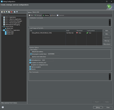

  • My linker file for both CM7 and CM4 FLASH entry are set accordingly
  • Debugger configurations for both CM7 and CM4 Startup->Set program counter (hex): are set accordingly

Here are my debugger settings for both cores:
CM7
CM4

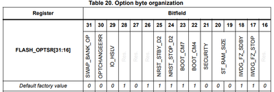

Well the BCM4 flag OB was the culprit. I am finally running both cores!
I have read through the STM32CubeIDE and STM32CubeProgramming manuals and I've never seen anything that explains the Option Bytes. The STM32CubeProgrammer Section 2.4 simply reads "For more details refer to the option bytes section in the programming and reference manuals, available from www.st.com
Which manuals is it referring to?
Does STM have a central location for all of the documentation? I have also perused all of the docs shown on the CubeIDE Information Center and I never saw anything about Option Bytes. Where is the document that explains Option Bytes?

Hi @rtalan
Yes, all the documents are on st.com, usually including the reference manual, data sheet, errata sheet and application note:
https://www.st.com/en/microcontrollers-microprocessors/stm32h745-755/documentation.html
If I understand correctly, you are still using the Arduino Portenta H7 board, which has a dual-core STM32H747?
Well, there's the documentation for tools such as STM32CubeIDE or CubeProgrammer, and there's also the numerous device documentations.
The Reference manual in question is RM0399, which you can find here.
https://www.st.com/resource/en/reference_manual/rm0399-stm32h745755-and-stm32h747757-advanced-armbased-32bit-mcus-stmicroelectronics.pdf
Their description is in section 4.4 FLASH option bytes.
As the STM32H747 is dual-core, both the Cortex-M7 and M4 cores are enabled for all devices leaving our factories. This is the default configuration (see RM0399 in Table 20. Option byte organisation) and you would find this on one of our NUCLEO-H745ZI-Q or STM32H747I-Discovery boards:

I think that disabling the BOOT_CM4 byte option is done by Arduino? Do their SDK and example use both cores? I don't know?
