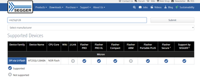

J-Link has "universal" QSPI flash programmer where you only have to specify pinout of the QSPI/OSPI controller and the flash chip is detected automatically. Details & bug reports -> Segger J-Flash forum.
‎2024-09-23 11:40 PM
I am having similar issue with MT25QL128. Unfortunately Jlink does not support
