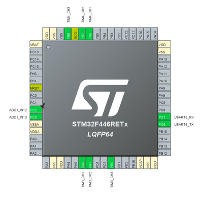

Do you have any conflicts between ADC and UART pins?

Check for any conflicts between ADC and UART pins?
Doesn't look like there could be any conflict. I will scrutinize the PCB itself more
