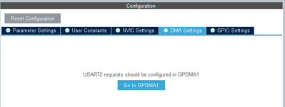

- I enabled DMA which gave me:

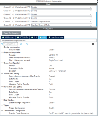

- Then I set up GPDMA1 for huart2_TX and huart2_RX. My TX configs are:
