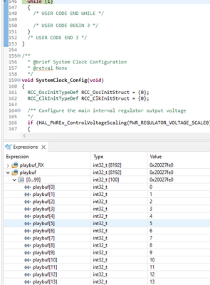

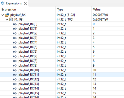

I would like to use DMA with SAI but I am having difficulty writing the code. Can you check if my code is correct and why I cannot retrieve the RX values ?
  /* USER CODE BEGIN 2 */
  HAL_SAI_RegisterCallback(&hsai_BlockA1, HAL_SAI_RX_HALFCOMPLETE_CB_ID, HAL_SAI_RxHalfCpltCallback);
  HAL_SAI_RegisterCallback(&hsai_BlockA1, HAL_SAI_RX_COMPLETE_CB_ID, HAL_SAI_RxCpltCallback);
  fresult= HAL_SAI_Init(&hsai_BlockA1);
  if (fresult != HAL_OK)
  	return HAL_ERROR;
  fresult = HAL_SAI_Receive_DMA(&hsai_BlockA1, (uint8_t *)playbuf_RX, (sizeof(playbuf_RX))/4);
  HAL_SAI_RegisterCallback(&hsai_BlockB1, HAL_SAI_TX_HALFCOMPLETE_CB_ID, HAL_SAI_TxHalfCpltCallback);
  HAL_SAI_RegisterCallback(&hsai_BlockB1, HAL_SAI_TX_COMPLETE_CB_ID, HAL_SAI_TxCpltCallback);
  fresult= HAL_SAI_Init(&hsai_BlockB1);
  	return HAL_ERROR;
  fresult = HAL_SAI_Transmit_DMA(&hsai_BlockB1, (uint8_t *)playbuf , (sizeof(playbuf))/4);
With CubeMX I have configured 2 DMAs.
One to send the data and the other to read the data again.
I think I'm missing something for the callback but I don't know how to use it to retrieve the values.
Thank you for your helps.

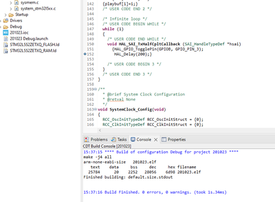

Thank you for your helps, I'll look for the documentation for that. I modified my code to know if the transmission is correct via the HAL_SAI_TxHalfCpltCallback function :
  while (1)
    /* USER CODE END WHILE */
	void HAL_SAI_TxHalfCpltCallback (SAI_HandleTypeDef *hsai)
	  {HAL_GPIO_TogglePin(GPIOB, GPIO_PIN_3);
	   HAL_Delay(200);}
    /* USER CODE BEGIN 3 */
So for me something is wrong with the transmission since the LED never flashes.
LCE
Principal II
You got it completely wrong...
You are declaring a function within the while loop - and the compiler does not complain? Interesting.
LCE
Principal II

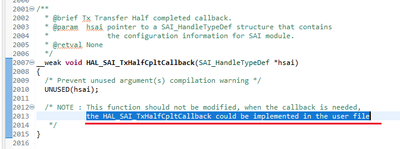

And again, usually callback functions are not for you to call them, it's another function that does that, in the HAL case it should be called by the DMA / SAI complete ISR. Try to find where the callback is called within the HAL functions.
Maybe the interrupts you need are not active?

I'm not sure if you're right, no errors during compilation :
I saw a tutorial and you can do this to find out if the transmission is going well. The proof is that I have no errors during compilation.
I think this function is useful to know if the transmission is going well.
Why am I looking at this function ? Because the DMA is configured in circular. After I can check for RX.
Normally the interrupts is automatically generated by cubemx right ? How to check this interruption ?

DYann.1
Senior II
Now it's ok
I just to change the configuration and I configure the SAI in DMA only for transmission but not for reception.
