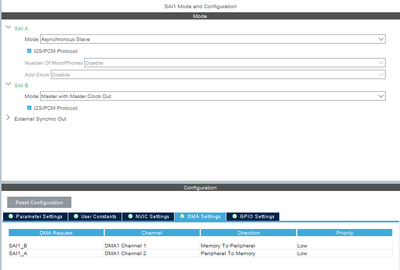

I would like to use DMA with SAI but I am having difficulty writing the code. Can you check if my code is correct and why I cannot retrieve the RX values ?

With CubeMX I have configured 2 DMAs.
One to send the data and the other to read the data again.
I think I'm missing something for the callback but I don't know how to use it to retrieve the values.
Thank you for your helps.
Regards.

I configure SAI_RX via CubeMX and nothing else and the code is :
  HAL_SAI_RegisterCallback(&hsai_BlockA1, HAL_SAI_RX_HALFCOMPLETE_CB_ID, HAL_SAI_RxHalfCpltCallback);
  HAL_SAI_RegisterCallback(&hsai_BlockA1, HAL_SAI_RX_COMPLETE_CB_ID, HAL_SAI_RxCpltCallback);
  fresult= HAL_SAI_Init(&hsai_BlockA1);
  if (fresult != HAL_OK)
  	return HAL_ERROR;
The SAI inits is too big to show here but the code is generated from CubeMX.

Before I delete my RX array (for example all at 0) and I use this code to retrieve the values :
for (i=0;i<8192;i++)
  {playbuf_RX[i]=0;}
  {playbuf[i]=i;}
  	return HAL_ERROR;
  HAL_SAI_RegisterCallback(&hsai_BlockB1, HAL_SAI_TX_HALFCOMPLETE_CB_ID, HAL_SAI_TxHalfCpltCallback);
  HAL_SAI_RegisterCallback(&hsai_BlockB1, HAL_SAI_TX_COMPLETE_CB_ID, HAL_SAI_TxCpltCallback);
  fresult= HAL_SAI_Init(&hsai_BlockB1);
  	return HAL_ERROR;
  fresult = HAL_SAI_Receive_DMA(&hsai_BlockA1, (uint8_t *)playbuf_RX, (sizeof(playbuf_RX))/4);
  	return HAL_ERROR;
  fresult = HAL_SAI_Transmit_DMA(&hsai_BlockB1, (uint8_t *)playbuf , (sizeof(playbuf))/4);
  	return HAL_ERROR;
Just after HAL_SAI_Transmit_DMA you'll have your data in the RX array which comes from the TX array.
