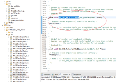

@AScha.3 wrote:
2. set a breakpoint at receive callback
How to do that ? Where I can find the information for this function ? I would like to call this function in the Main to know when reception is complete (RX) ?
I already checked the clock signals yesterday and I have good signals.
the secrets of HAL ....
look in the drivers/hal../src  : H7...hal_sai.c -> what you have to write as function name <- this will be called
(without the "__weak " of course ! )

Very good ! But I don't have drivers/hal../src : H7...hal_sai.c as you say. I have STM32L5xx but
it still looks like. So I try to call this Function in my Main just to see if the RX is complete.

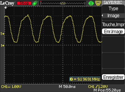

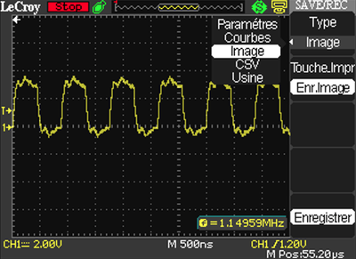

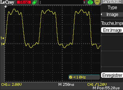

I'll come back for the signals :
FS_B
SCK_B
MCLK_B

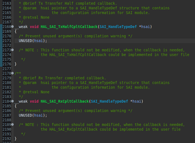

LCE
Principal II
You don't understand the callback's purpose:
It's not something you call to check, it should be called automatically when the DMA triggers the half- / complete interrupts. Check the HAL files.
Just because the examples do not exactly fit your purpose, you should look at theses and understand what's going on. Are there no SAI playback / record examples for L5 ?
