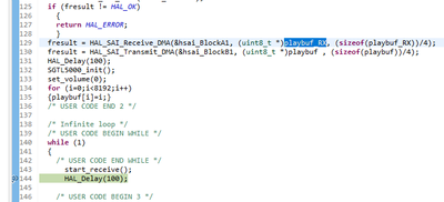

I would like to use DMA with SAI but I am having difficulty writing the code. Can you check if my code is correct and why I cannot retrieve the RX values ?
  /* USER CODE BEGIN 2 */
  HAL_SAI_RegisterCallback(&hsai_BlockA1, HAL_SAI_RX_HALFCOMPLETE_CB_ID, HAL_SAI_RxHalfCpltCallback);
  HAL_SAI_RegisterCallback(&hsai_BlockA1, HAL_SAI_RX_COMPLETE_CB_ID, HAL_SAI_RxCpltCallback);
  fresult= HAL_SAI_Init(&hsai_BlockA1);
  if (fresult != HAL_OK)
  	return HAL_ERROR;
  fresult = HAL_SAI_Receive_DMA(&hsai_BlockA1, (uint8_t *)playbuf_RX, (sizeof(playbuf_RX))/4);
  HAL_SAI_RegisterCallback(&hsai_BlockB1, HAL_SAI_TX_HALFCOMPLETE_CB_ID, HAL_SAI_TxHalfCpltCallback);
  HAL_SAI_RegisterCallback(&hsai_BlockB1, HAL_SAI_TX_COMPLETE_CB_ID, HAL_SAI_TxCpltCallback);
  fresult= HAL_SAI_Init(&hsai_BlockB1);
  	return HAL_ERROR;
  fresult = HAL_SAI_Transmit_DMA(&hsai_BlockB1, (uint8_t *)playbuf , (sizeof(playbuf))/4);

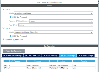

With CubeMX I have configured 2 DMAs.
One to send the data and the other to read the data again.

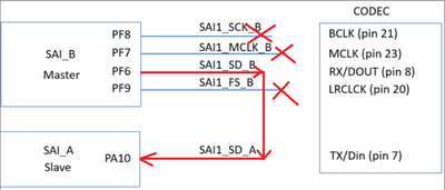

Thank you for your feedback but I my goal is not to check the example programs. I've seen 2 examples and it doesn't match what I'm doing. Especially since there was no '.ioc' file so we can't see anything. So I can give to you my configuration and the purpose of my test. I just want to send the data through the SAI (playbuf) and retrieve (playbuf_RX) it in a table to validate the operation of my SAI. I created 2 buffers one for sending and the other for receiving. I looped the TX with the RX together
I configured the SAI with DMA, one for sending and the other for receiving :
If I initialize my sending table then in principle I must have the same values ​​as in my receiving table right ?

ok, i see start -> transmit dma...
but no start :   HAL_SAI_Receive_DMA(SAI...) - try. (and maybe better, start receive first, then transmit .)
DYann.1
Senior II
Hi AScha,
Are you sure ? In my code I initialized the slave before the master like this :
ah, didnt see it,  ok.   but i would put the  HAL_SAI_Receive_DMA() just close to transmit start..
 (might change nothing...just try.)
HAL_SAI_Recieve_DMA...
HAL_SAI_Transmit_DMA...
Just one thing : how to know that the RX_buffer is completely filled (there is no Flag to indicate?) and how to recover the data? Do I have to create another function or is it managed automatically by the SAI DMA callback ?

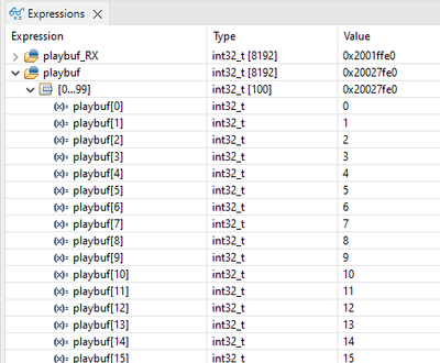

so to test: write some 0xAFFE to the transmit buffer and zero to receive buffer and start dma's then.
then stop in debug and look at the receive data...should be no more zeros there.
After your advice
And I filled my TX array (playbuf) like this

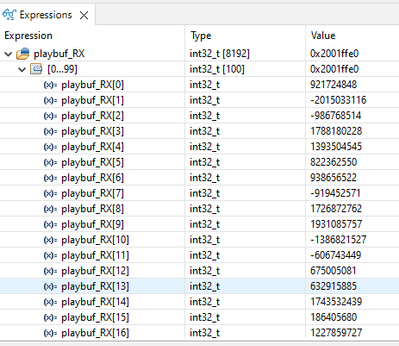

I make a breakpoint and I watch the array playbuf_RX :
For me there is no transmission. What's wrong ?

what cpu we have here?  (H7 -> disable d-cache !  )
+ preset arrays before starting dma .
1. check with a scope...clk, wclk generated really ?
2. set a breakpoint at receive callback - then you know, its coming there at all !
