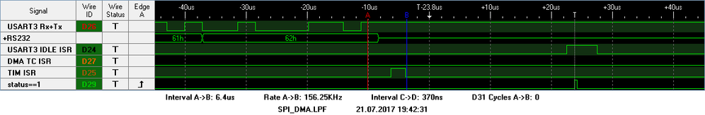

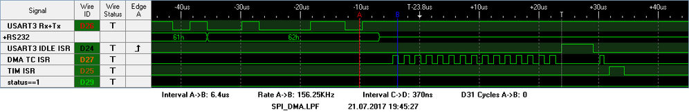

To reproduce the original issue, I took a
; took the bulk of your sources (rewrote the intro of course as I despise Cube :) ); to simulate your transmitter I employed Tx of the same USART3, filled by DMA in the main loop, followed by a trivial loopdelay; shorted PC10 to PC11 on the DISCO by a jumper for loopback; removed printouts, added several pin toggles to follow the execution path.(I also had to randomize somewhat the timer ISR, as for certain code length it got inadvertently synchronous with the USART/DMA process, hiding the problem - see below for the role of the timer ISR).
I can confirm your initial finding: the Rx DMA with 4N+k, k=1..3 bytes to transfer, switched-on FIFO and word-transfer on memory side, occasionally ends with NDTR = 0 and TCIF *not* set.
Further findings:
- Normally, if TCIF *is* set, the DMA1_Stream1_IRQHandler() is fired and (in its original incarnation) continues to fire as it does not clear TCIF. That puzzled me: as it has the same nesting/group priority as the USART IRQHandler but has a lower number, given the interrupt-entry rules, how comes the USART IRQHandler fires at all? I wrote a separate test to confirm that if you have two interrupts with the same priority active at the same time, and they never deactivate their trigger, they both fire in alternating fashion. If you add a third, then depending on whether it's higher on the list (lower number) or not, it is never fired or it replaces in the alternating pattern one of the former ISRs. I guess, during the tail-chaining process, the list of pending interrupts is polled *except* the active one. This is not a very practical but still interesting snippet of information which is IMO not that clear from the available Cortex-M documentation.
- I confirm that if k=0 (i.e. fulfilling the requirement of UM to have NDTR multiple of memory-side transfer width when FIFO is used), TCIF is always set and everything behaves as expected.
- FIFO threshold has no influence on all what's written here; the same good or bad behaviour is seen (although from sampling the FIFO level during transfer I see that FIFO itself obeys the set threshold and empties itself if it is reached).
- Regardless of whether TCIF is or is not set, all the transferred data are stored into the memory, and - as documented in UM and discussed above - a whole word is stored into memory, with the outstanding bytes having the ''old'' value from the FIFO. For example, when transferring 16+2 bytes 01 02 03 04 05 06 07 08 09 10 11 12 13 14 15 16 17 18 the rx buffer in memory is written by 16+4 bytes 01 02 03 04 05 06 07 08 09 10 11 12 13 14 15 16 17 18 03 04
- Regardless of whether TCIF is or is not set, HTIF is *not* set at the tranfer end, if k=1..3; it is set properly if k=0. I wonder what exactly is the mechanism behind this one.
- When TCIF is *not* set, SxCR.EN is *not* cleared!!! (while NDTR *is* zero). Manually clearing SxCR.EN in this case sets TCIF.
- TCIF got *not* set only when the TIM13 ISR fell into a relatively narrow range closely after the USART transfer ended (see between A and B cursor in the picture below).
My assumption was that the problem is due to collision on the APB1 bus, but I was wrong - I changed TIM13 for TIM11 which is on APB2 and the result was the same
- Moving the DMA buffer from SRAM1 to SRAM2 removed the issue. While the TIM ISR did not explicitly access SRAM, the stack was in SRAM1. Conclusion thus is, that if (k > 0) && (DMA memory-side write is delayed because of SRAM AHB bus contention) then SxCR.EN does not get cleared and TCIF does not get set.
