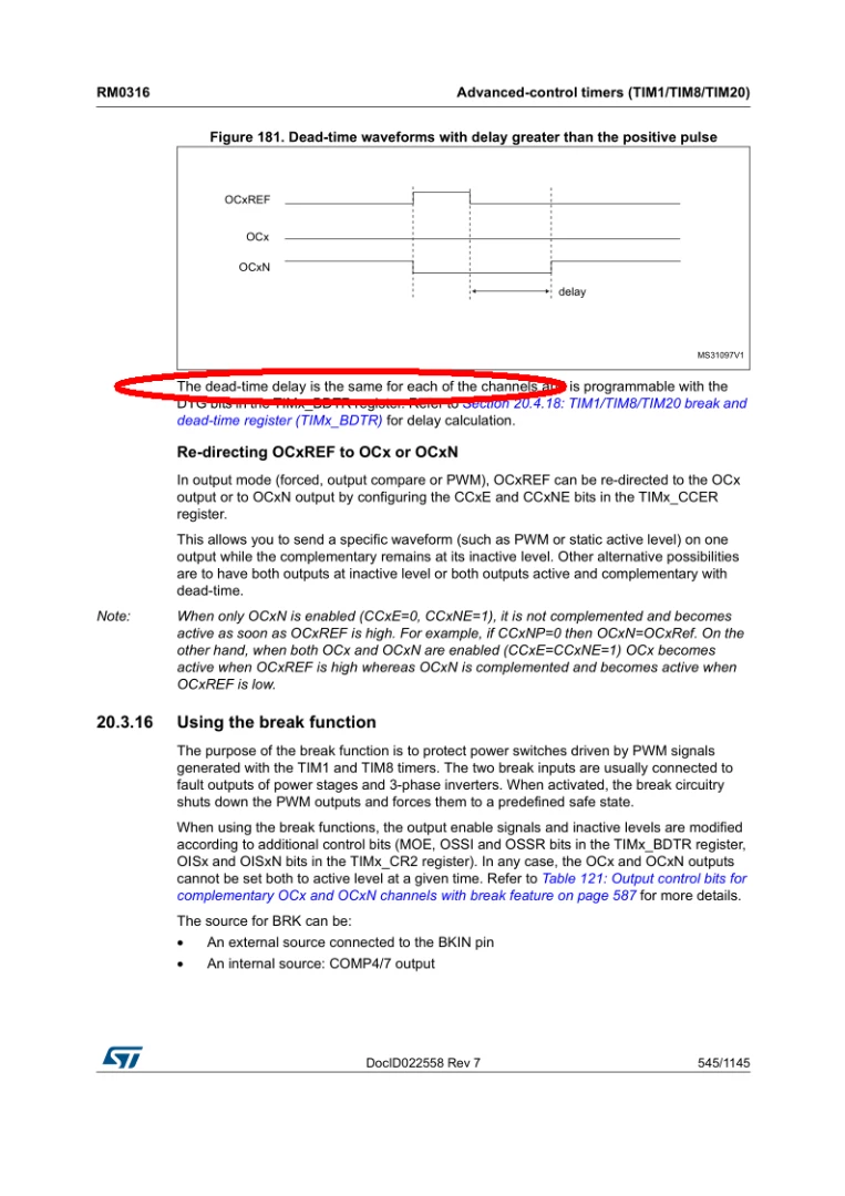

I'm using the advanced timer TIM1 on STM32303VC to drive a 2 phase shifted full bridges separated by a transformer (Dual Active Bridge topology). This required use of 4 PWMs. CH1 and CH1N drive the primary bridge. CH3 and CH3N drive the secondary bridge.
The question is I need to program independent dead times (for CH1-CH1N and CH3-CH3N). Is that possible? Because the LL APIs have only one dead time configuration value per Timer.
If it's not possible what is the workaround? This is a make or break situation for my converter.
No.
Using two different timers?

Can I apply phase shift if I drive the bridges using two different timers? Also I need to apply this work around in my existing hardware.  So that means I can configure Tim1_ch3-ch3n as input high impedance and short it with Tim8_ch1-ch1n. That should work right?

    The STM32F334 has the HRTIM with an independent deadtime control for each channel.
    Why your phase shift bridge need independent deadtime?

The reference manual mentions resynchronization delay but it never mentions what value will this resync. delay be.
Good question; I've never seen the inter-timer TRGO-TRGI delay properly specified - maybe in some of the appnotes?. TIMx_SMCR.MSM bit description vaguely hints about delaying the effect of TRGI ' to allow a perfect synchronization between the current timer and its slaves'; I've never tried that either.
