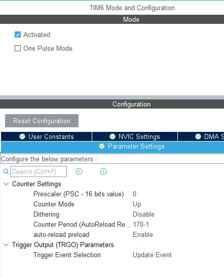

The signal is sampled with the TIMER6 trigger, which is rised every 1us. (MCU clock is 170MHz, TIMER6 PSC is 0 and ARR is 170-1).
TIMER6 configurationTIMER6 configuration

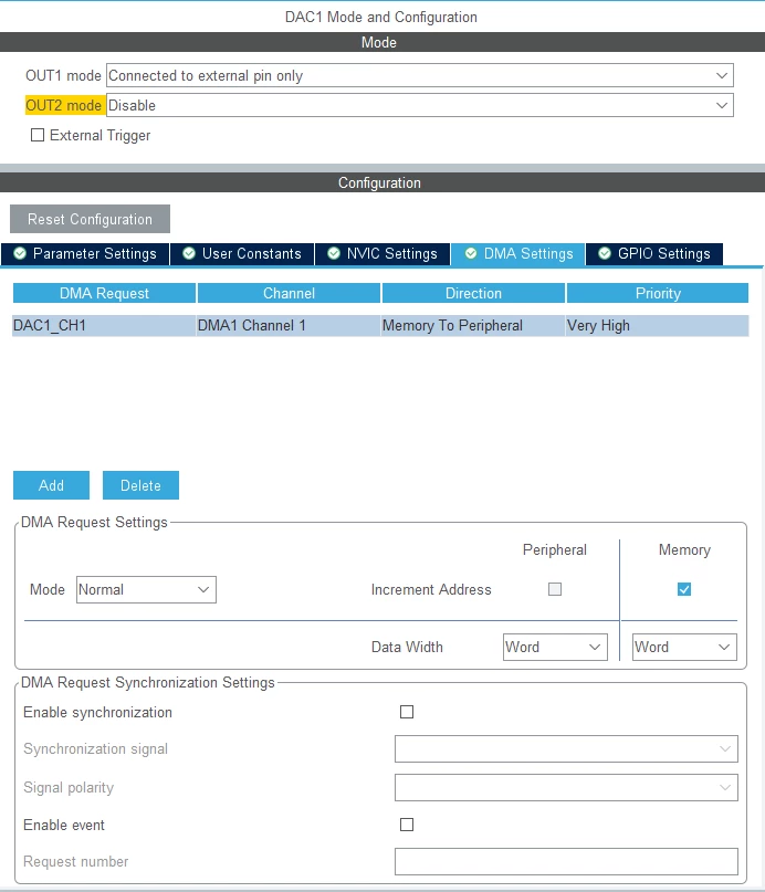

The DMA is set to normal mode (because I want to generate a signal only when the trigger comes, and not continuously)
DAC DMA configurationDAC DMA configuration

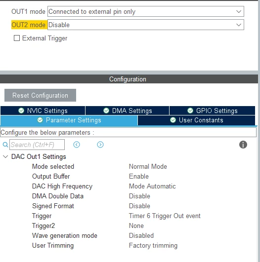

 The DAC is configured like this:
DAC configurationDAC configuration

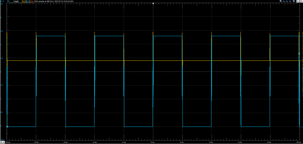

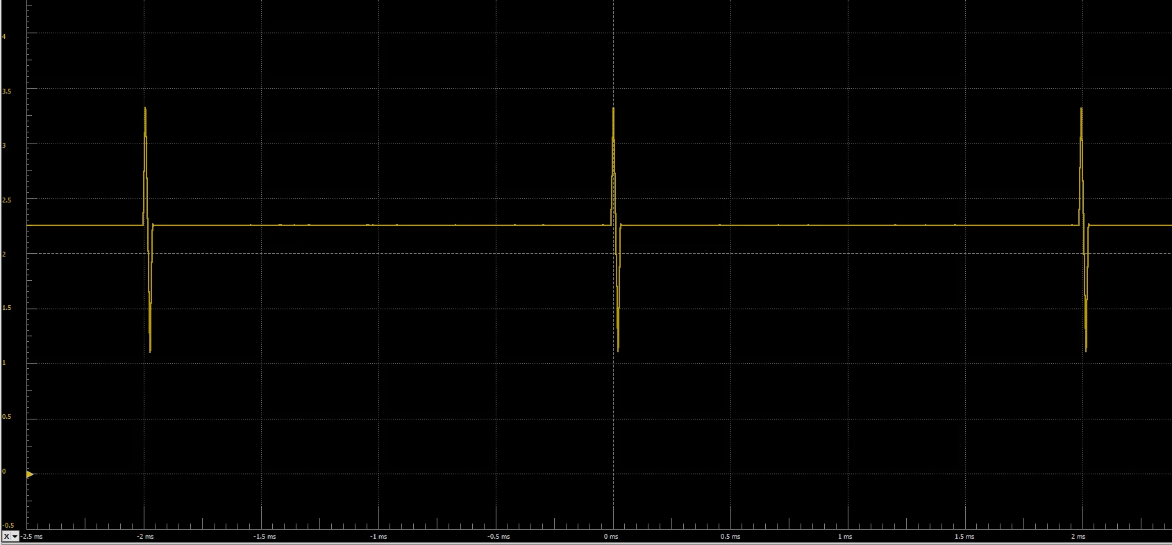

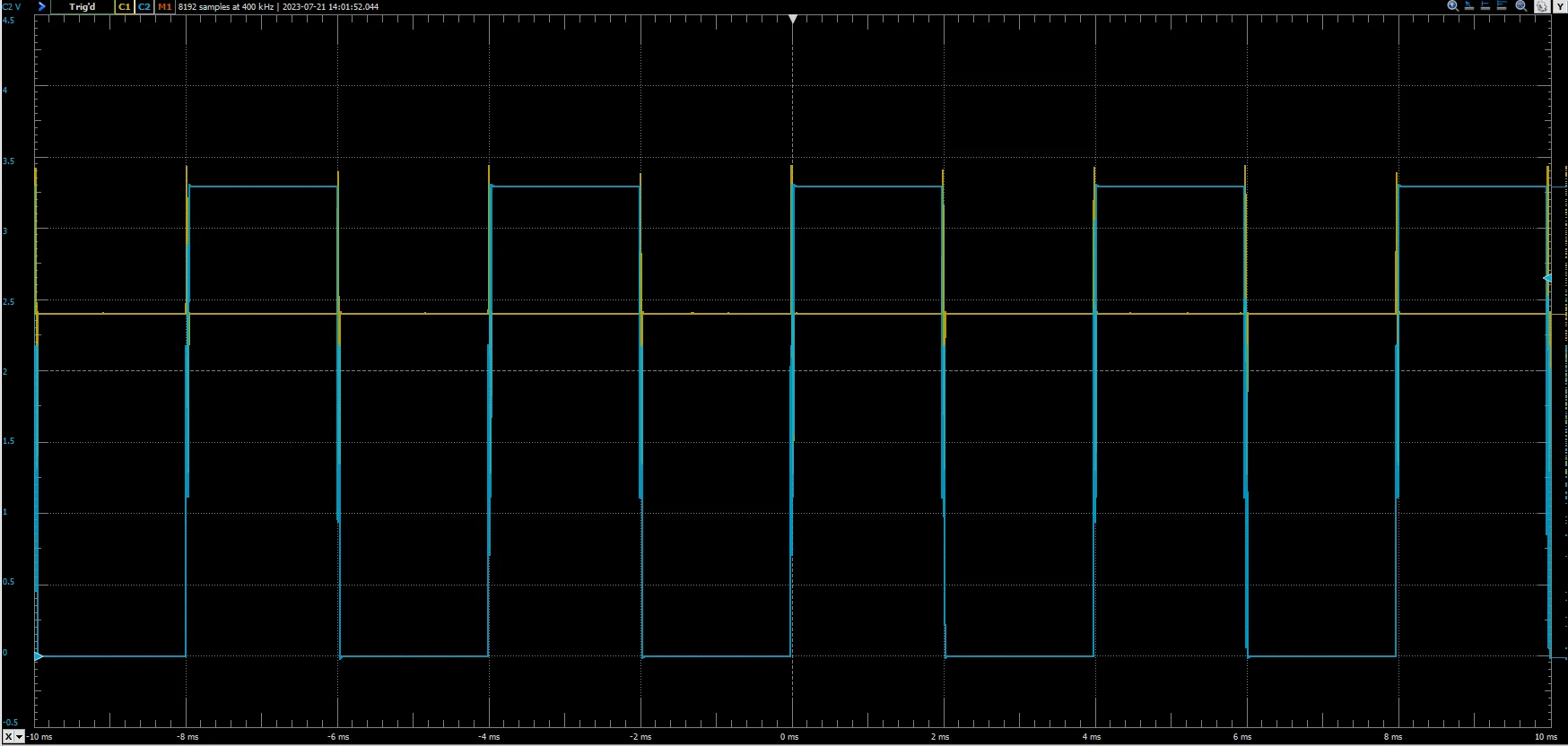

 I'm calling the HAL_DAC_Start_DMA function each time the external trigger rises, but, even if the trigger is repeated each 1ms, the signal is generated each 2ms. The minimum interval between a signal generation and another one is 2ms and basically I need to reduce it as much as possible.
SignalSignal
Here the trigger is faster than 2ms but the signal is generated each 2msHere the trigger is faster than 2ms but the signal is generated each 2ms

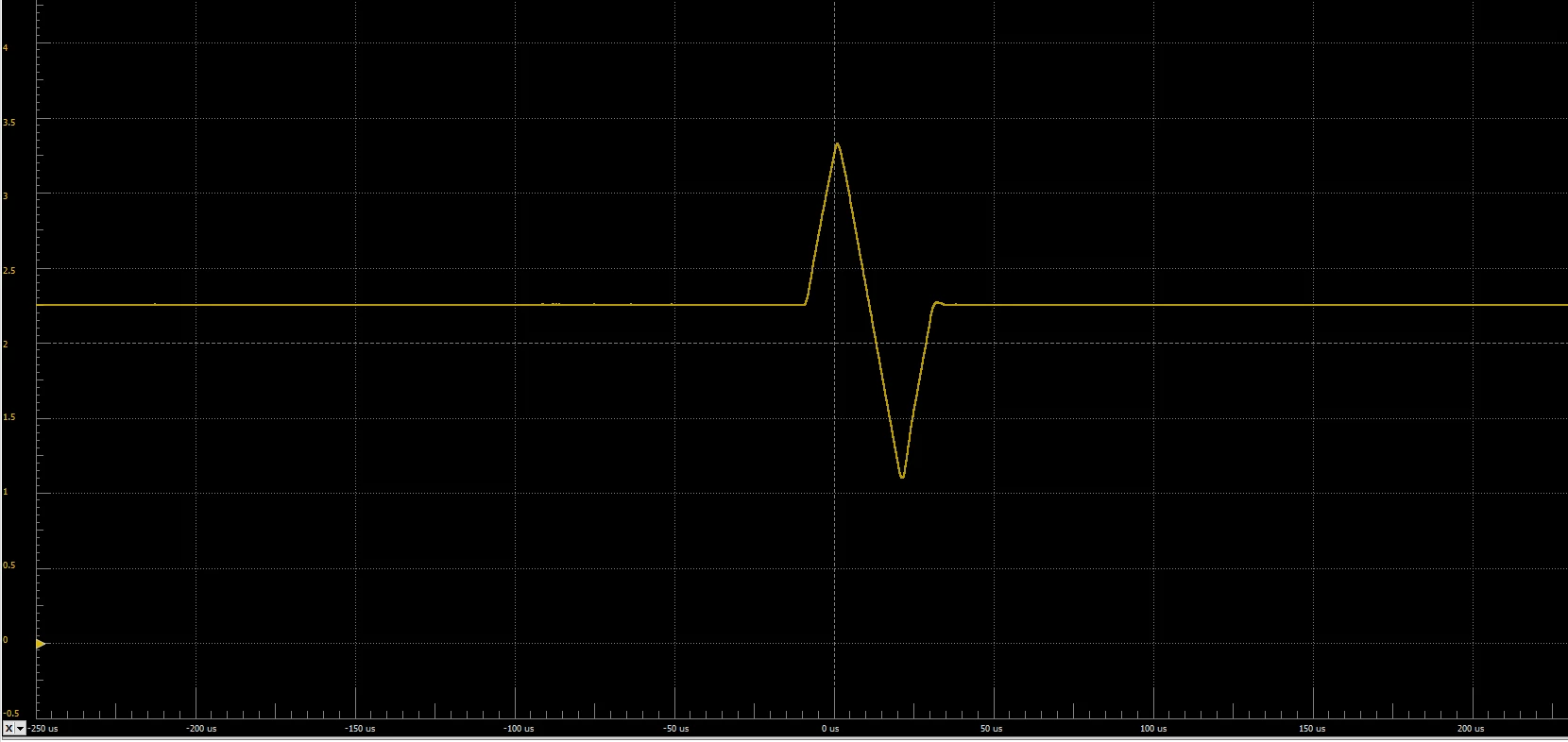

By setting the DMA in circular mode I don't obtain the wanted behaviour. I mean: I don't want to generate continuously the waveform, I want to generate the signal only when the external trigger rises. The signal duration is about 50 us, and the trigger can come in any moment. Actually if the trigger comes before 2ms from another one it will be ignored which is bad form my application.

July 21, 2023

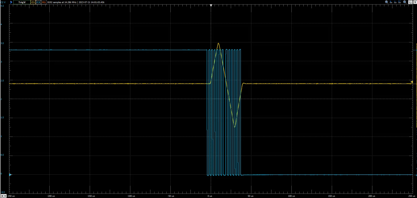

I tried to continuously call HAL_DAC_Start_DMA in the while loop followed by a HAL_GPIO_TogglePin and the result is:
waclawek.jan
July 21, 2023
How? I don't understand. Please post relevant code.

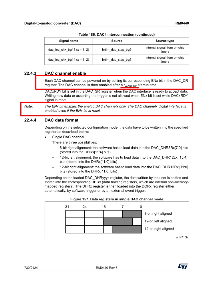

It's apparently consequence of incorrectly handled/misunderstood remark from the RM:
The delay according to 'G431 DS is:
but, as the highlighted remark above indicates, this delay is only in the analog part, nothing prevents the digital part to work normally.
So, to generate a quasi-continuous waveform, it's not just matter of removing the delay, but you should also avoid switching the DMA [EDIT see post below] DAC [/EDIT] off and on.
