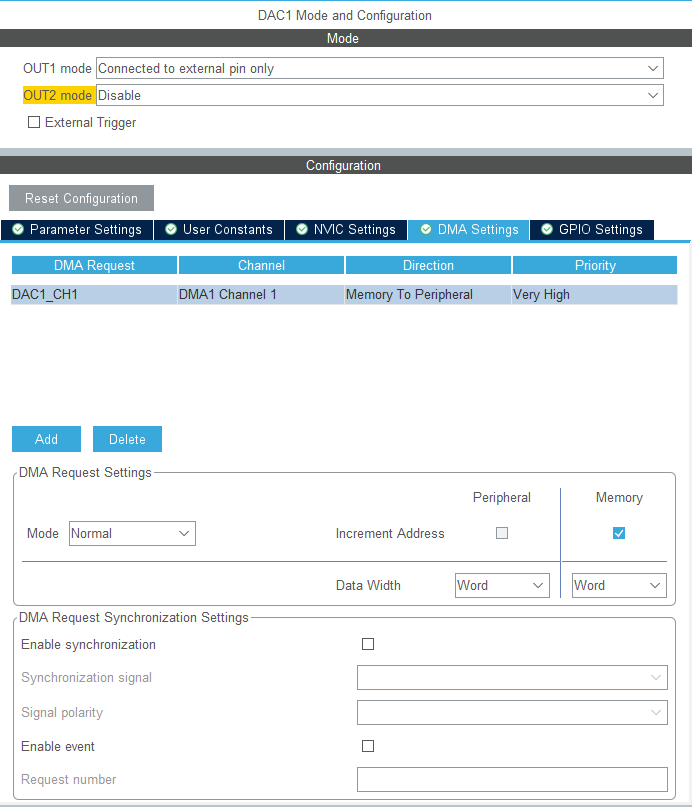

The DMA is set to normal mode (because I want to generate a signal only when the trigger comes, and not continuously)
DAC DMA configurationDAC DMA configuration

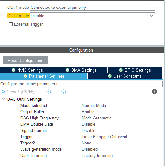

 The DAC is configured like this:
DAC configurationDAC configuration

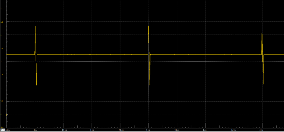

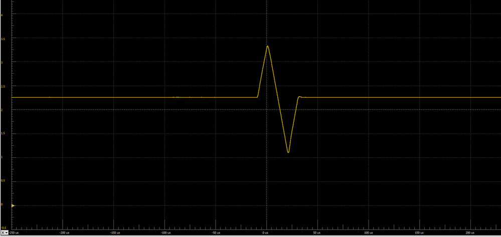

 I'm calling the HAL_DAC_Start_DMA function each time the external trigger rises, but, even if the trigger is repeated each 1ms, the signal is generated each 2ms. The minimum interval between a signal generation and another one is 2ms and basically I need to reduce it as much as possible.
SignalSignal
Here the trigger is faster than 2ms but the signal is generated each 2msHere the trigger is faster than 2ms but the signal is generated each 2ms

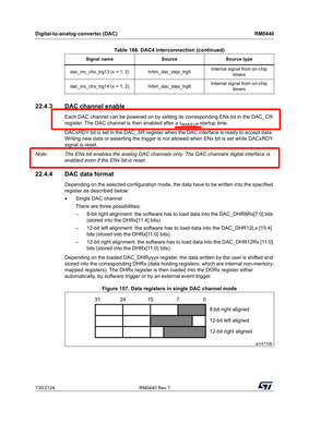

waclawek.jan
It's apparently consequence of incorrectly handled/misunderstood remark from the RM:
The delay according to 'G431 DS is:
but, as the highlighted remark above indicates, this delay is only in the analog part, nothing prevents the digital part to work normally.
So, to generate a quasi-continuous waveform, it's not just matter of removing the delay, but you should also avoid switching the DMA [EDIT see post below] DAC [/EDIT] off and on.

Sorry, my bad, I meant, you should not switch *DAC* off/on (i.e. you should remove __HAL_DAC_ENABLE() / __HAL_DAC_DISABLE() from the functions you are using to start/stop DMA). I've corrected above.
Btw. I went through the Cubes and I found the delay only in 'G4 and 'U5 HAL, whereas the analog part setting (tWAKEUP) is - logically - present and of similar duration in other STM32 families which have DAC, too.
