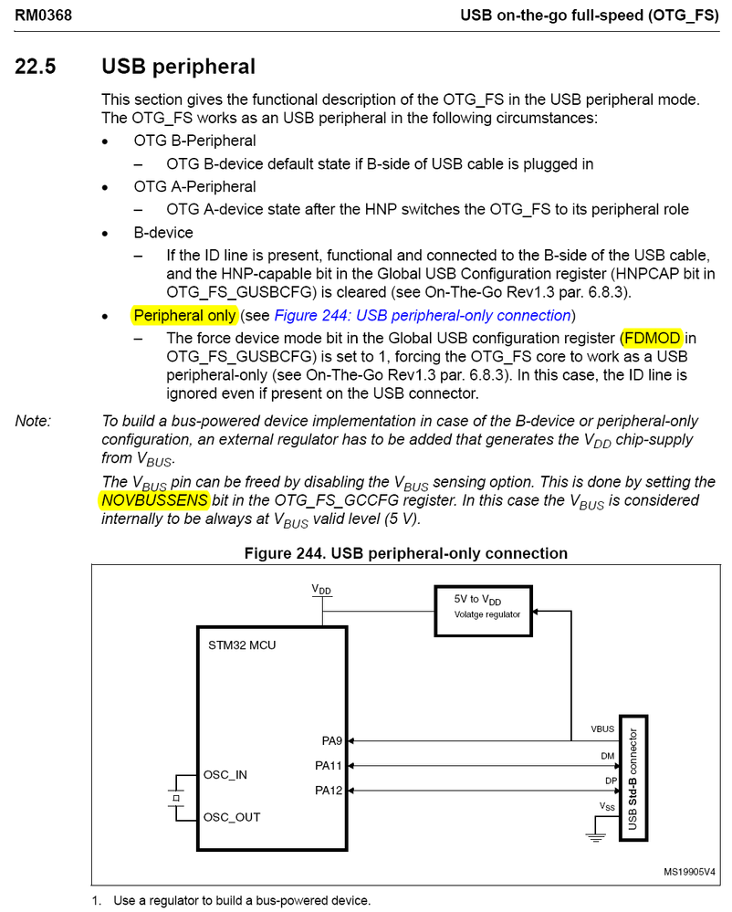

Hi all,
Is the VUSB input required/recommended for self-powered STM32 USB device?
From everything ive read, the VUSB input is required for connection/disconnect detection, but in practice, everything seems to work just fine without it.
I've looked through the ST USB device library, and while there is a switch for VUSB/SELF_POWERED device support, it seems to nothing whatsoever (the switch/var is never checked by any of the ST USB device library code).
So... am i safe to just not use the VUSB input?
That pin is rather valuable and could be used elsewhere.
Thanks in advance!

brent239955_st
Posted on August 10, 2016 at 16:10
From ''
http://www.st.com/content/ccc/resource/technical/document/reference_manual/5d/b1/ef/b2/a1/66/40/80/DM000968pdf/files/DM000968pdf/jcr:content/translations/en.DM000968pdf
'' , page 669:
The VBUS pin can be freed by disabling the VBUS sensing option. This is done by setting the
NOVBUSSENS bit in the OTG_FS_GCCFG register. In this case the VBUS is considered
internally to be always at VBUS valid level (5 V).

waclawek.jan
The USB specification requires the device not to output any signal onto the data lines (DP/DM), if there is no valid voltage on VBUS.
So, if you want to implement a device conforming to the USB specification, you either power it from VUSB (i.e. "bus-powered device"), or if it has an independent power source (i.e. "self-powered device"), you should not enable the USB transceiver until you detect valid voltage on VUSB. You can detect it in any way, not necessarily using PA9, although most of the libraries probably assume the latter.
