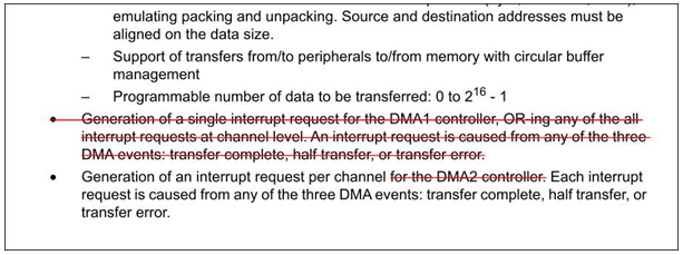

In RM0440, it states that "Generation of a single interrupt request for the DMA1 controller," however looking at the exception vectors indicates that there is a separate interrupt vector for each channel for both DMA 1 and 2. Also the stm32cube library header files reflect this.

Agreed. the NVIC interrupt vector Table 97 shows eight separate vectors for DMA1 and another eight separate vectors for DMA2.
ST needs to update the document.

I confirm the issue; there is mistake in the RM0440.
The figure below shows the correction to be applied: 0693W00000NsTTlQAN.pngI reported this issue internally.
Internal ticket number: 130717 (This is an internal tracking number and is not accessible or usable by customers).
Kaouthar

Hello @Pete4 ;
The issue is fixed in RM0440 Rev9.
Thank you.
Kaouthar
