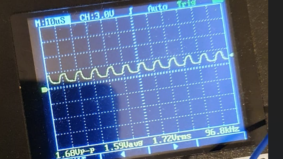

Hi everyone!
I'm using a custom board with an stm32l051 and an lsm6ds3(and two 4.7kohm pull-ups). I am setuping the I2C1 (pins PB7 SDA and PB8 SCL). then I do the IMU setup in which I write some values to control registers on the IMU. then I read the IMU who am I reg and it says 0x6A (should be 0x69) and when I read every other register they are all at zero accept of the CTRL9_XL reg that is 0xE0. I don't really understand what is happening.
I'd love to hear your opinions.
Many thanks, Eyal Porat

Andrew Neil
have you used an oscilloscope to look at what's actually happening on the wires?
https://electronics.stackexchange.com/a/473799
Thanks for the comment!
I looked at the signal yesterday and it seems ok. I'll upload a picture later cause I don't have enough hands at the moment:)
Eyal
Also, from what I see in the scope the read data is correct
