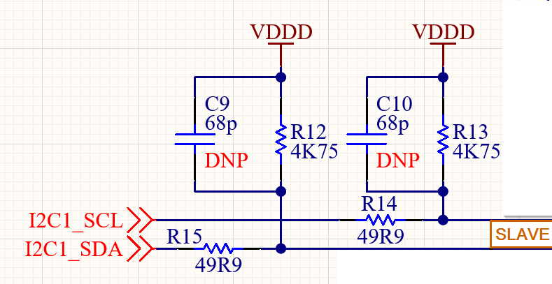

I am using STM32F303CB microcontroller, connected with a I2C slave which has no CLK stretching support. The I2C bus lines are pulled high with 4k75 ohms resistors and the lines have a serial resistor of 50 ohms (approx.). The schematic looks like the one in the image below.

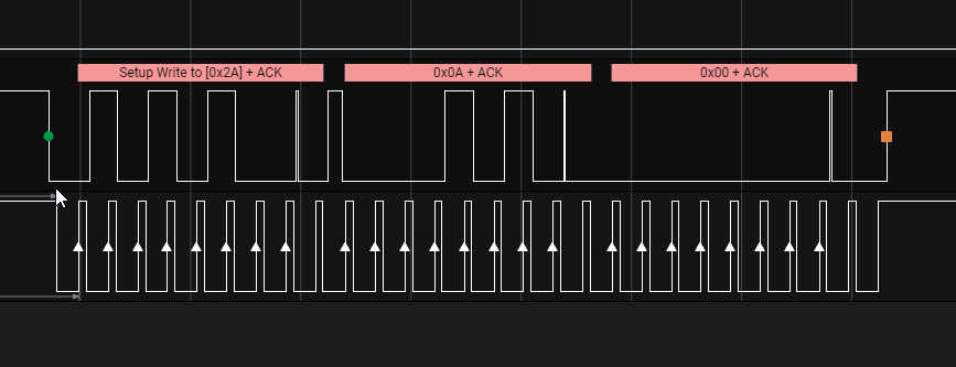

Normally, the transmitted data should look like the image below (0x2A -> slave address, 0x0A -> memory location inside slave, 0x00 -> data to be written inside that memory).

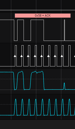

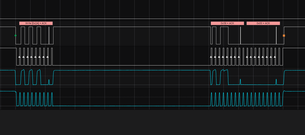

However, on these certain PCBs, the memory location byte of the slave is transmitted improperly over the I2C bus. The µC is "supposedly" transmitting 0x58 instead of 0x0A.
Note - the CLK stretching also happens on a proper transmission and hence, shall be ruled out as the cause for this error.
If it was a bit shift or something, I can understand this kind of error. But it was far from a bit shift. 0x0A -> 0x58 shift is something that I cannot understand. Hence, I tested the analog side as well, and noticed that there was no spur/glitch detected (500 MS/second).
As I said earlier, the slave cannot control the I2C bus (no CLK stretching!). There are no interference happening on the PCBs. The test environment is the same for all the PCBs under testing. There are no voltage spikes or strange noise on the bus/voltage system.

For example if you define your transmit buffer as a local variable and then exit the function which called HAL_I2C_Master_Transmit_IT ().
MagSense
Hi. Its true that the transmit buffer variable was lost since it was a local variable. Thanks for the suggestion! Really helped!
I caught the data that is actually written to the TXDR and it was 0x58.Thanks!
