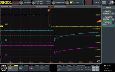

  4. We observed that CS & WR pins go low for ~300 ns during MRST, which seems to be the trigger.
Below is waveform captured for the mentioned behaviour.

It seems that on WARM reboot (keeping controller powered on) causes all GPIO pins to go LOW for approx. 5ns and 300ns rise time.

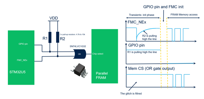

Anyway, it's under analysis and will update you as soon we have any news. I don't know how it will take but if you are hurry, I can propose the following as a workaround (you need to test it):
  • The idea is to filter the first glitch on the GPIO alternate function (FMC_NEx).
  • An OR gate (SN74LVC1G32) will be used with a pull-up resistor that pulls one of the OR gate inputs to high forcing the output to high during the reset period where the GPIO pins is in analog input (Hi-Z). No matter the FMC_NEx level, the OR gate output will be set to 1 protecting the memory to be selected by its chips select.
  • Before configuring the FMC, a dedicated GPIO pin needs to be used and needs to be set to low then configure it to output push pull. At that time FMC_NEx level is already stabilized at high level and the memory chip select is not yet asserted.
  • When the FMC starts to read/write from/to the memory, FMC_NEx starts to toggle according to these operations and the OR gate output will follow and the MCU can access normally to the memory.
  • Need to take care of the OR gate propagation delay in the FMC timing config.
    Thank you for the suggestion.  We have implemented similar Logic on FRAM CS and it is working.
