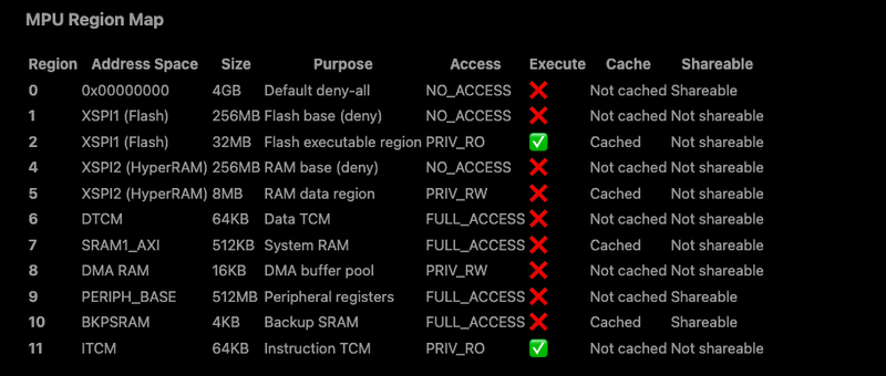

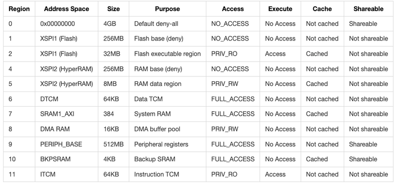

MPU Region Map
  • I-Cache: Enabled (instruction fetch optimization)
  • D-Cache: Enabled (data fetch optimization)
  • Both caches critical for maintaining performance with external memory access at 600 MHz

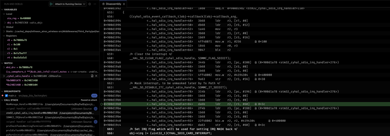

Root Cause Analysis of Main Issue:
When the application runs, I encounter hard fault with the following characteristics:
Please refer to following capture of Fault capture, which is explained in detail below:
IMAGE 1 :
IMAGE 2 :
Understanding the Memory Fault Above
This is a pointer corruption issue caused by corrupted data being read from external flash memory. Let me break down the failure sequence:
The MCU tries to execute following C Code, and triggers fault at executing
__HAL_SD_DISABLE_IT(_cyhal_sdio_handle, SDMMC_IT_SDIOIT);
void stm32_cyhal_sdio_irq_handler(void)
    uint32_t sta_reg = _cyhal_sdio_handle->Instance->STA;
    cyhal_sdio_t* obj = (cyhal_sdio_t*)_cyhal_sdio_handle->Context;
    if ((_cyhal_sdio_handle != NULL) &&
        (__HAL_SD_GET_FLAG(_cyhal_sdio_handle, SDMMC_STA_SDIOIT) != RESET))
        ((cyhal_sdio_event_callback_t)obj->callback)(obj->callback_arg,
                                                     CYHAL_SDIO_CARD_INTERRUPT);
        /* Clear the interrupt */
        __HAL_SD_CLEAR_FLAG(_cyhal_sdio_handle, SDMMC_FLAG_SDIOIT);
        /* Mask interrupt, to be unmasked later by Tx Path */
        __HAL_SD_DISABLE_IT(_cyhal_sdio_handle, SDMMC_IT_SDIOIT); <- FAULT AT THIS LINE

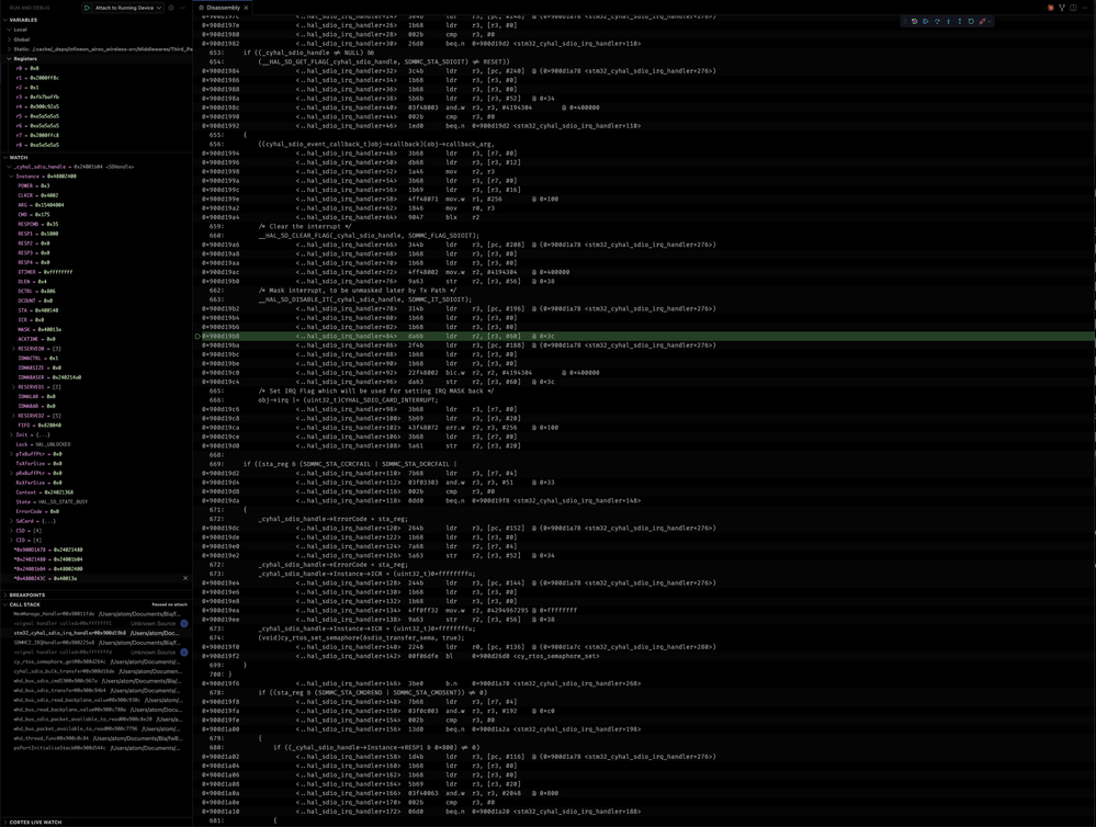

The Execution Flow
Understanding the execution flow of above code with Disassembly:
This single line of C code __HAL_SD_DISABLE_IT(_cyhal_sdio_handle, SDMMC_IT_SDIOIT) compiles to the four assembly instructions that are failing catastrophically (check image 2 for clear reference):
ldr r3, [pc, #196] // Load address of _cyhal_sdio_handle
ldr r3, [r3, #0] // Dereference _cyhal_sdio_handle
ldr r3, [r3, #0] // Access _cyhal_sdio_handle->Instance
ldr r2, [r3, #60] // Read Instance->MASK (at offset 60)

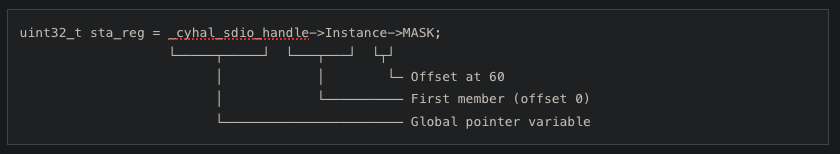

Detailed Breakdown

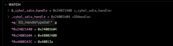

Pointer Dereferences
1. Get the address of the global variable _cyhal_sdio_handle:
ldr r3, [pc, #196]
// Equivalent to: &_cyhal_sdio_handle
// R3 = 0x24021480 (address where the handle pointer is stored)
2. Dereference to get the handle value:
ldr r3, [r3, #0]
// Equivalent to: _cyhal_sdio_handle
// R3 = *0x24021480 = 0x24001b04 (the actual sdio handle)
3. Access the Instance member (first member of the struct, offset 0):
ldr r3, [r3, #0]
// Equivalent to: _cyhal_sdio_handle->Instance
// R3 = *0x24001b04 = 0x48002400 (Instance address)
4. Read the STA register (at offset 60 bytes in SDMMC_TypeDef):
ldr r2, [r3, #60]
// Equivalent to: _cyhal_sdio_handle->Instance->MASK
// R2 = *(0x48002400 + 60) = 0x40013a (MASK value)
Why This Particular Line Fails
The Corruption Point
The very first instruction reads from the literal pool in external flash:
ldr r3, [pc, #196]  // Reading from 0x900D1A78 in external flash
This literal pool contains the address of _cyhal_sdio_handle (0x24021480), but due to flash corruption, it reads UNKNOWNdata instead which starts the domino effect.
The Cascade Effect
Why This Causes a Fault
The corrupted address 0xFA7BAFFF points to unmapped/protected memory space, triggering the memory management unit (MMU/MPU) to generate a hard fault when the CPU attempts to access it.
The corrupted pointer value (0xfa7bafff) indicates that data being read from the external flash via XSPI1 is incorrect. This is not a pointer that exists in my code - it's garbage data resulting from communication errors.
VIDEO
Video Showing Corrupted R3 along with Disassembly View Showing Call Stack is HERE
