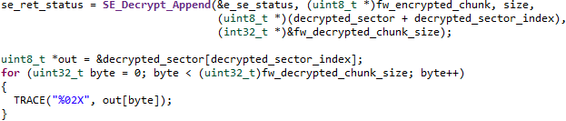

I’m integrating SBSFU v2.7.0 on an STM32WB55 to enable secure OTA firmware updates. I’m hitting a problem where the runtime hash verification fails: the hash computed by SBSFU at boot does not match the hash in the image header, so the image is erased.
I dump the decrypted bytes in RAM (before programming) over LPUART and convert them to a binary for comparison with the build output. Assuming the dump/conversion are correct, the streams match up to ~60 KiB, then diverge consistently until the end of the file. This suggests the symmetric key is correct and the early pipeline is fine, but later bytes are corrupted before or during the decrypt-in-place / program sequence.
Here is how printing every decrypted chunk within DecryptImageInPlace function:

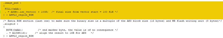

Using a single binary, I performed three download attempts of the encrypted firmware to our custom board. The decryption issue consistently occurs, though it begins at different memory addresses each time — for example, at 0x0F6C0, 0x0F010, and 0x0F100. I also observed that the corrupted data tends to become repetitive towards the end of the files.
I made some adjustments to ST’s user application example by extending the application size using the linker script —  added a section just before the 16-byte padding that ensures proper AES alignment:
P.S: The binary ended up being filled with zeros rather than 0xAA, but it still seems to function correctly for our testing purposes.
Interestingly, when testing with a 100 KB update, the process fails during the hash digest comparison in the ST example. However, after reducing the padding to 50 KB, the update succeeds and the example application runs correctly. I also noticed that the update progress bar moves smoothly from 0–100% with the 50 KB image, whereas for 100 KB (and our actual application, which is over 200 KB), the progress halts intermittently and the overall update process takes significantly longer.
This makes me wonder whether there might be a limitation or oversight in either the ST BLE Sensor app or the SBSFU package that prevents proper handling of larger firmware updates.
