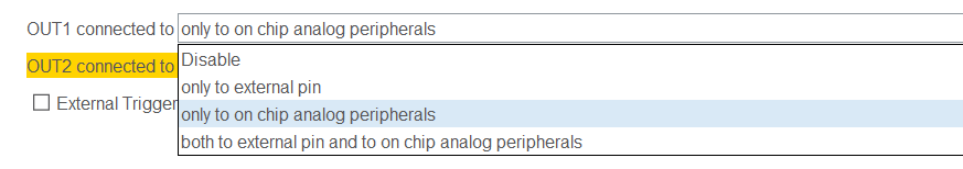

I am in the process of bringing up a prototype board with a STM32L4R7ZIT6 up. I'm using one DAC channel via the opamp. This is working all right, until I designate the default output of the DAC to another function e.g. dig output.
The DAC is configured as 'only to on chip peripherals.' If the io-pin is at reset state, the output voltage appears at the opamp output pin.

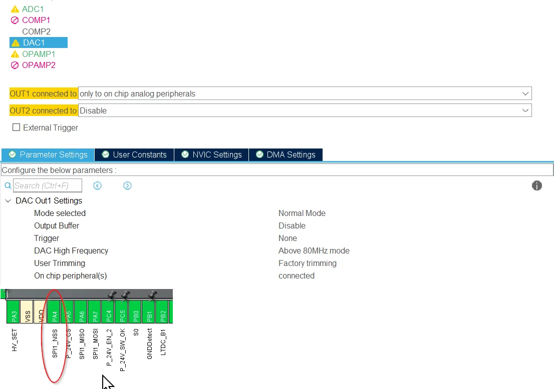

In my IO-setting, I need PA4 for its function as 'spi1_nss'. For my application, I like to lower the output impedance of the DAC. So, two flies in one catch. Use the OPA as a follower, and free PA4. The strange thing is, this is working OK when PA4 is in reset state. So the DAC is feeding the OPA, and the OPA is conveying the votage 1:1 to output PA3. When I set PA4 to 'reset state' the setup is working as expected. When I set PA4 to an output, or SP1_NSS, the voltage on PA3 does not follow the value set to the DAC. Checking the settings of the DAC and the OPA in the debugger shows exactly the same values in both situations.
When I have PA4 in reset state, and it is working as desired, I can change the state of PA4 in the debugger by modifing the two MODER4 bits. In reset state it is 3. With every other value, the output value of the PA (PA3) is immediately lowered to 0,3 V. When changed back to 3. the desired value apears again.

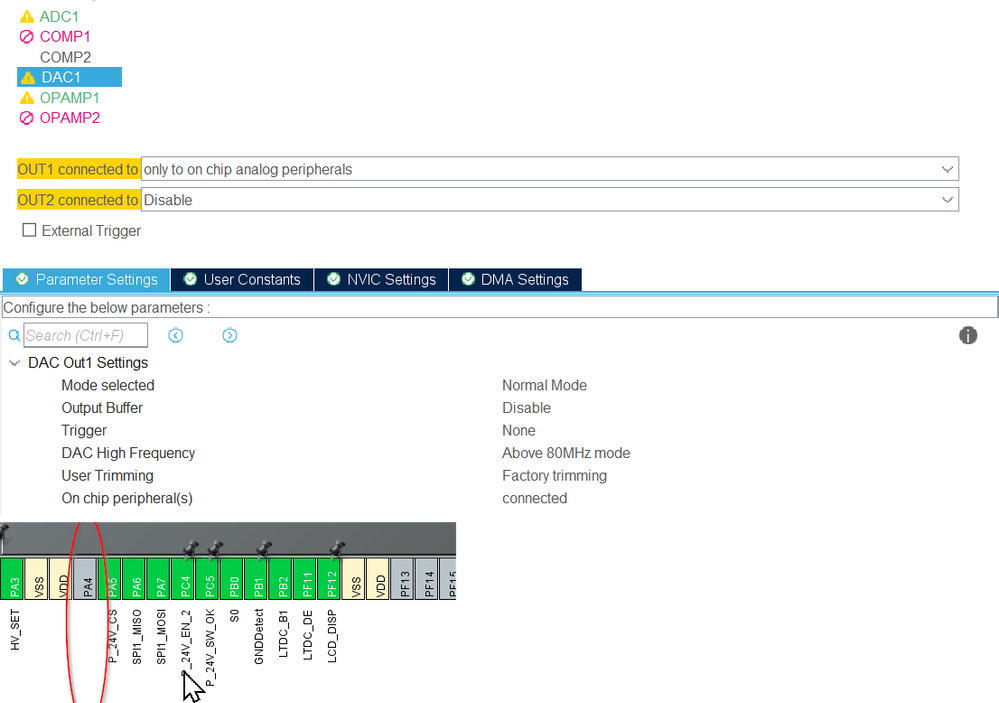

Pic 1: Desired situation, not working
Pic2: Situation that is working:

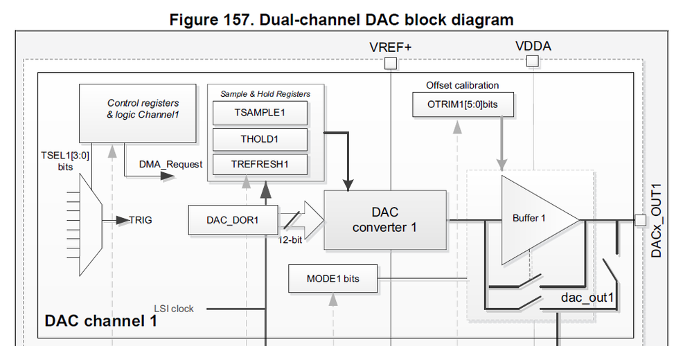

I see. I'd suggest  to check out bits fild in the DAC register, if it's realy connected to on-chip analog only. CubeMX may have bugs.
22.7.16 DAC mode control register (DAC_MCR)
Bits 2:0 MODE1[2:0]: DAC channel1 mode
These bits can be written only when the DAC is disabled and not in the calibration mode
(when bit EN1 = 0 and bit CEN1 = 0 in the DAC_CR register). If EN1 = 1 or CEN1 = 1 the
write operation is ignored.
They can be set and cleared by software to select the DAC channel1 mode:
– DAC channel1 in Normal mode
000: DAC channel1 is connected to external pin with Buffer enabled
001: DAC channel1 is connected to external pin and to on chip peripherals with Buffer
enabled
010: DAC channel1 is connected to external pin with Buffer disabled
011: DAC channel1 is connected to on chip peripherals with Buffer disabled
Also read Errata, there is DAC paragraph.

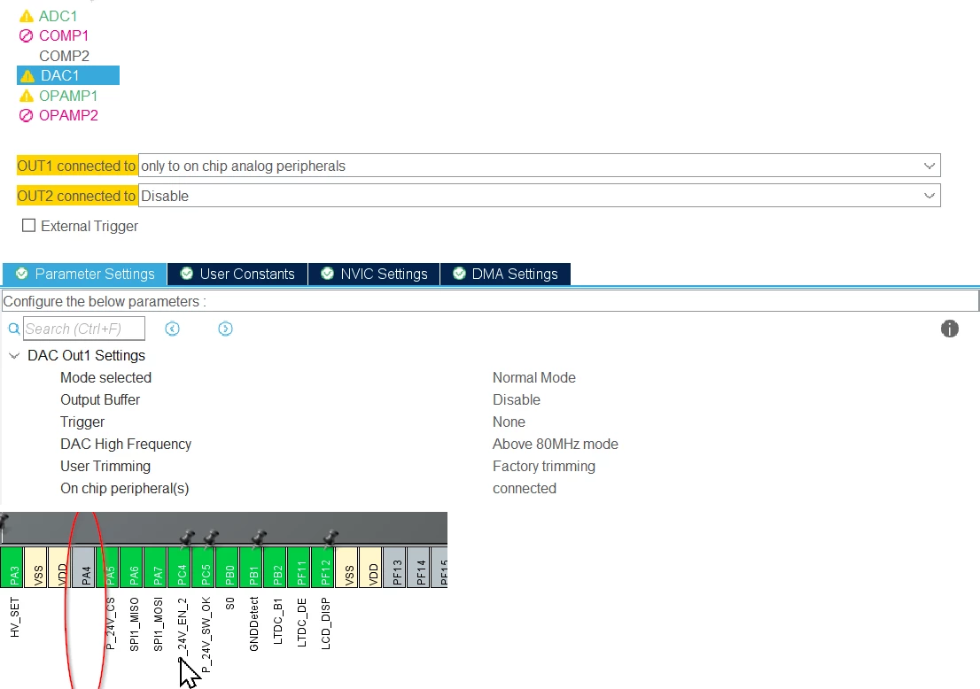

I did all that. I also made a new project with only the DAC and OPAMP configurated. It worked as expected correctly. Then I configured PA4 as output. Now there was a fixed value of 0.4V on the output signal on the OPAMP. I compared the initialisation code for the DAC, OPA and the GPIO. Only the GPIO code was different. And correct for the differencies in PA4.
In the debugger I paused the program and changed the MODER4 register of GPIO A to '3' (= reset). The correct analog value imediately appeared on the OPA output. I can only explain this a an impossibility to use PA4 for somethin else when the DAC can1 is used, or as an error in the CPU.
